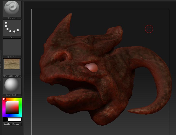

HI! I used Zapplink to texture this model while it had a matcap and coverted the polypaint col> Txr to a 1024 x 1024 texture using AUV Tiles.Upon reloading the tool I can’t change the material from the default red wax to a basic material using color > fill object ( that i guess will remove polypaint or texture , so I don’t know if that is what I should use ) because the Fill Object button is no longer active. I just want to view the texture on different materials. I am pretty sure I am missing a simple step somewhere. Kindly help.

  1. Select ‘Texture Off’ in the Texture palette.
  2. Press the Draw>M button (for material only).
  3. Select the material you want to use, or ‘Flat Color’ if you want the mesh to react to whichever material is selected.
  4. Press Color>Fill Object.
  5. Reselect your texture.
is there also a way to remove an assigned material from a tool? So it is getting assigned the current material again?
Yes, fill it with the ‘Flat Color’ material (index 0 in the material slider).
great! thanks a lot!
