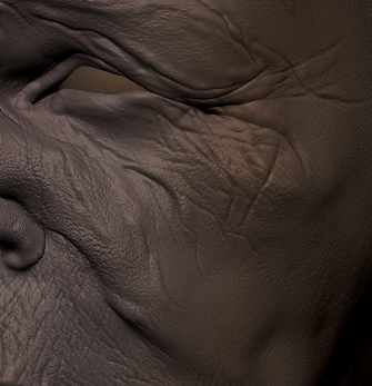

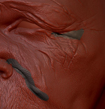

When I switch from Matcap Gray to any other material I see this unfilled (transparent?) areas:
No mask is on.
Why this could be happening?
Thanks.

it looks like it’s retaining some of the previous material. perhaps you inadvertently hit mrgb while working or something.
assuming you don’t have any polypaint on the model, try this.
turn on mrgb, then switch the material to “flat”, then from the color palette, fill object.
your materials should then work normally.
don’t forget to switch back to rbg afterward.
