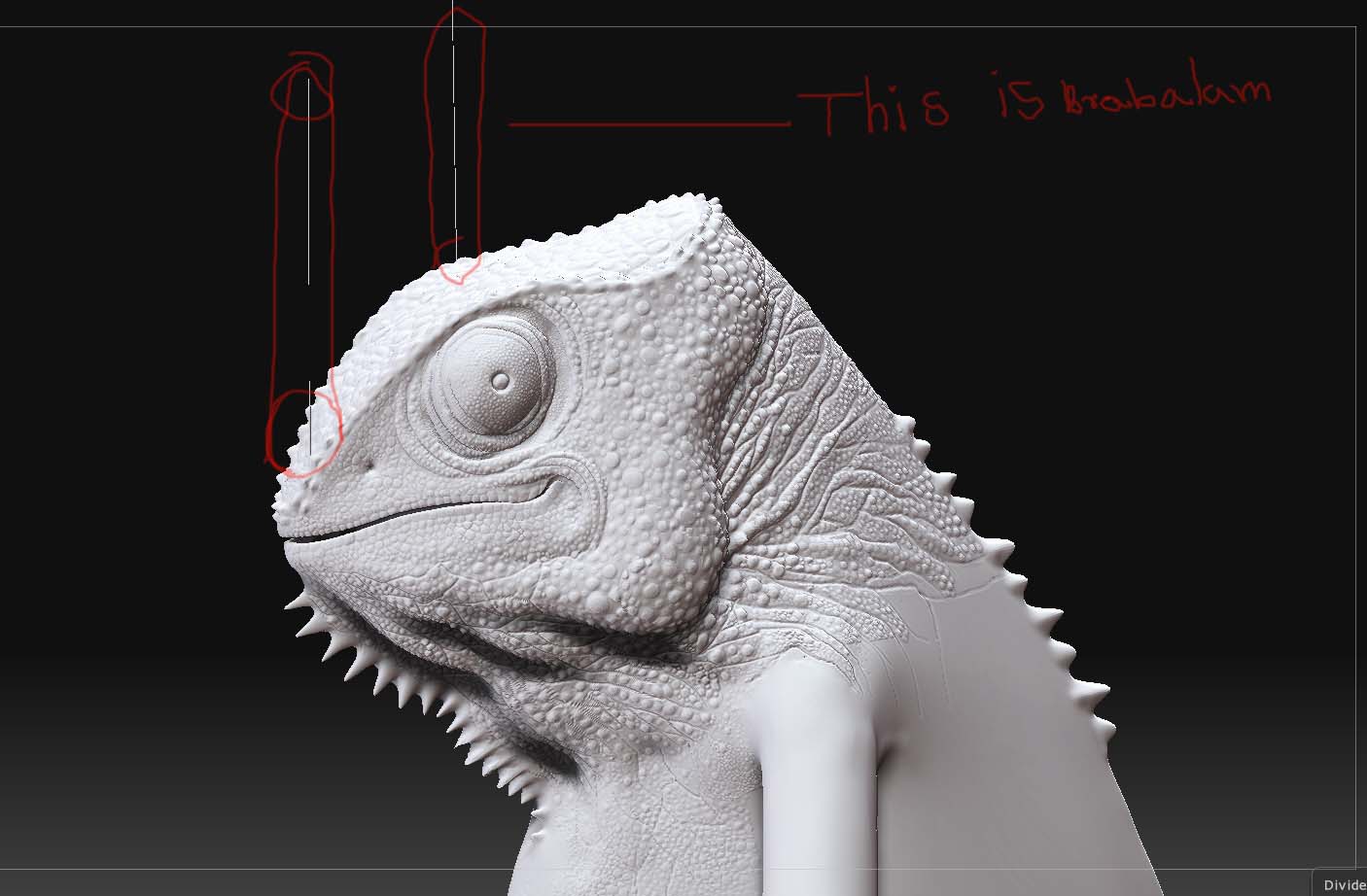

This is my second z brush job and iam facing some acute problems while modeling. Ive also attached as a reference. Initially when the model is low poly everything works fine but as an when i increase the subdivision to 4 or5, pol’s start to protude out. Ive tried to fix it by going back and re sculpt the whole thing but it wasn’t much of a help. Guys Please help me . same Brabalam first work also

Try dropping down one subdivision level and deleting higher, then dividing again.
You should also make sure that there’s not a scaling problem going on. How big is the model in the Tool>Preview window? If it’s tiny in that window, or way huge, you can encounter problems.
