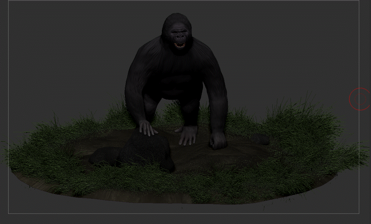

Was there ever an answer to this question? It’s something that really bothers me, i want my turntable’s ‘podium’ to be the center
As you can see here, with all the subtools etc. it offsets the center
Is there a way i can choose a centerpoint for the camera?

ok , I am at the PC now and … Maybe I am not understanding the problem right, it looks like the rotation is always taking place from the center of the space. not relative to the subtools…
if your podium is offset just move all the subtool…with transpose master …
I didnt have any problem… You just need to move all the subtools so the center of your podium is on the center of the space. you can find that point activating the floor. Its the origin of the 3 axes
Turning on the screen button seemed to affect nothing. My scene is framed around a (perfectly) circular subtool, so in theory if the whole thing is in shot in the first frame it should be in shot for the whole movie, but it’s not.
Also about moving all the subtools, other than being time consuming, there are certain times (Like for example now) when the subtools average centerpoint isn’t what you want it to spin around, my scene isn’t averaged to the center, because my character isn’t posed in a symmetrical way, also there are other subtools in the scene like the rocks which throw off the center point,
Your podium can be a perfect cylinder but its center isn’t in the space center … Moving all sub tools can be done with transpose master it’s just one action… I might be wrong but I tried with several subtools and placed them in different places and the turntable was always spinning around the space center
Is your circular podium center exactly on the space center?
Just forget about the subtools average … That’s what got me confused first . Try this experiment. Use any 3d object, make 3 or 4 duplicates. Offset them in any direction . Make turntables with the floor activated so you can see the center point. Keep moving them. Do you see any change I the rotation axis? in my copy of zbrush they always spin around the same point
I think the turntable axis can be set to x y z and it can be model or screen… In the movie subpalette. But the center is always the Same!
Ah, yeh it does circle around the grid you’re right. hm, well it’s a bit annoying i’ll have to move everything to the center. because of the pose for my character the grid is actually perpendicular to the base, and if i move it so the floor is in the center, the floor automatically jumps to the lowest point (Which as i’m trying to rotate around the Z axis is annoying)
