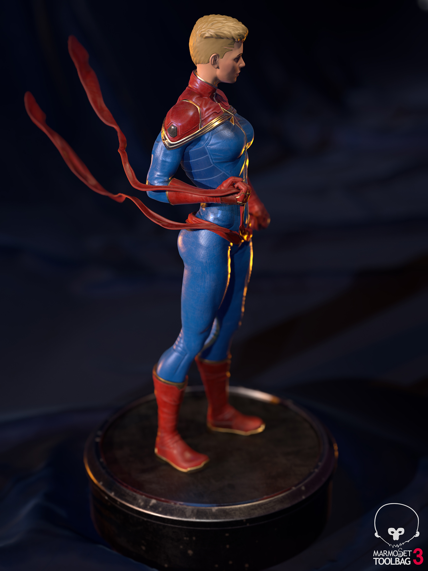

For my Captain Marvel render, I added 2 Key Lights, 2 Rim Lights and 2 Fill Lights and 1 HDRI.

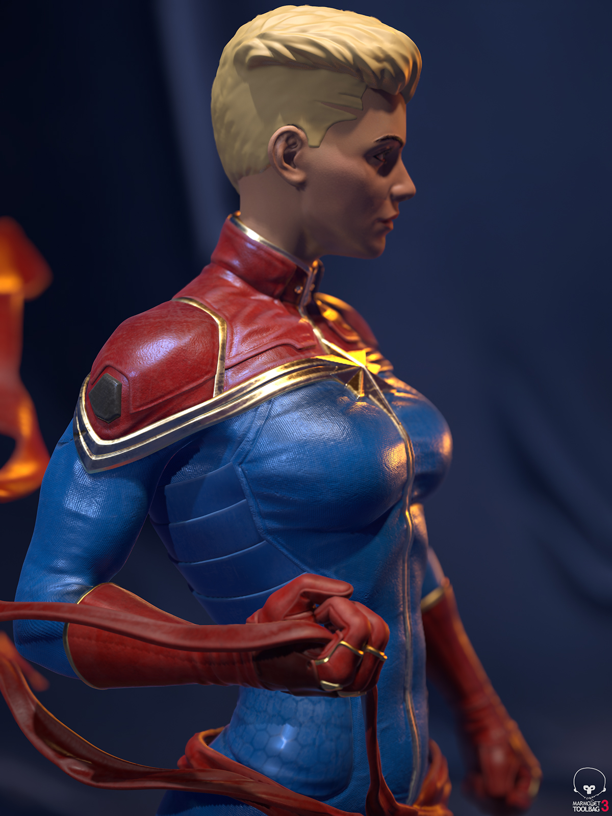

Use key lights to create deep shadows. Afterall lighting is just creating interesting shadows which adds depth to your scene.
Here I’ve added one key light from the side and one from the top in an attempt to create some interesting shapes in shadows.
[FONT=Arial]Add rim lights to define the character’s silhouette. Generally pointed from opposite side of the key light to shine in through the shadows
Added one for the silhouette and one for harsh highlights from top left (different color from the key light)

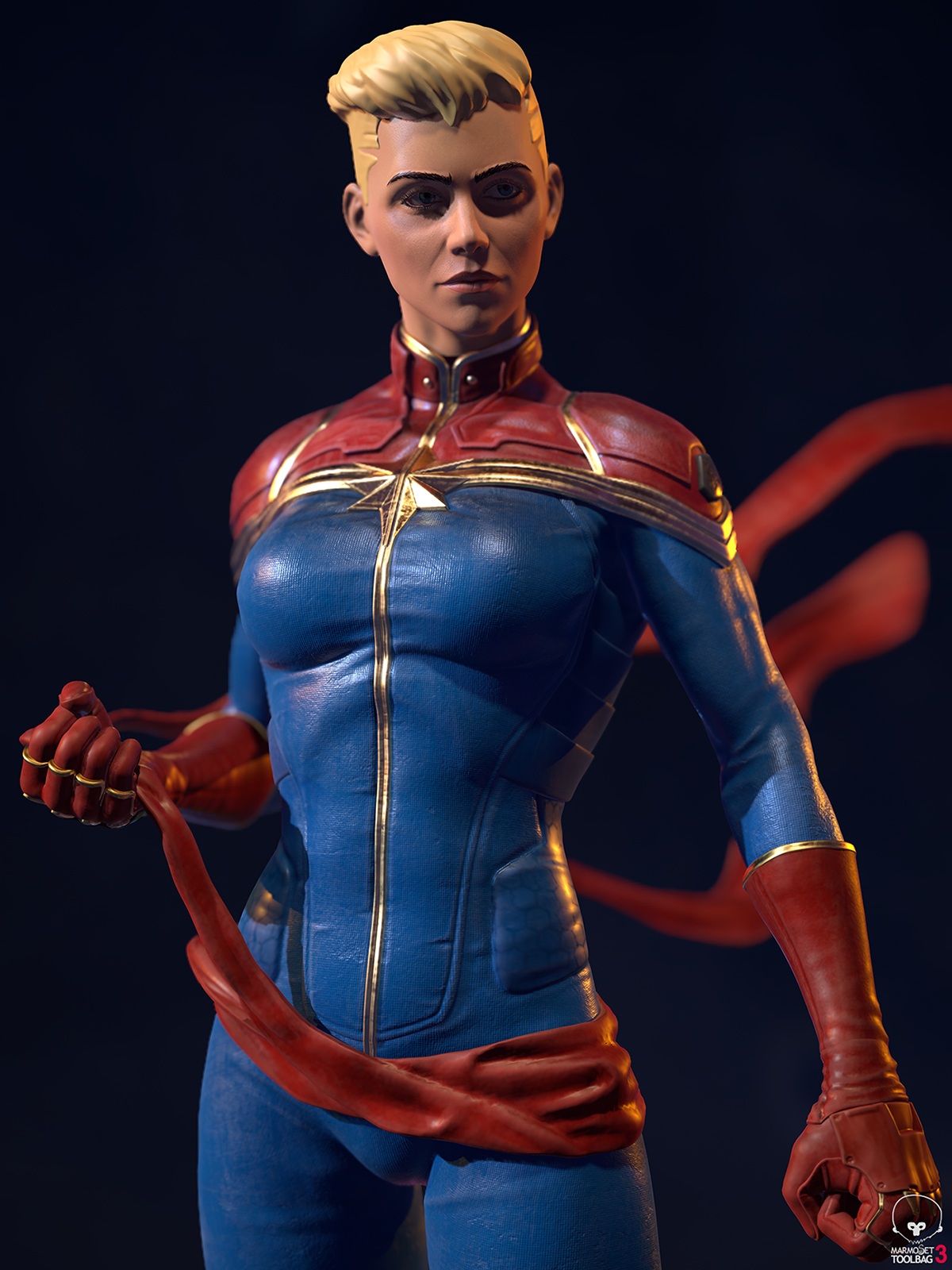

One thing about shadows is you don’t want them to be too dark. Well, harsh shadows are used at times to make interesting outputs but in most cases, you won’t find extreme dark shadows in real life(Funny thing is even in a street at night with no street light, the moonlight will work as a fill light. Hah :P)
So to get rid of the harsh shadows created by the key lights add fill lights(Lights with low intensity, just enough to decrease the shadow intensity). Generally, these are placed in opposite angle of key light. These can be even used to create soft highlights from the desired angle.
Hdri are good as a fill light as it’s not just one light coming from a single direction but softer lights coming in from every direction with various colors contributing to the output.
Here I’ve added one Fill light for the backdrop and one for some overall brightness. While the HDRI is working as the main Fill light.

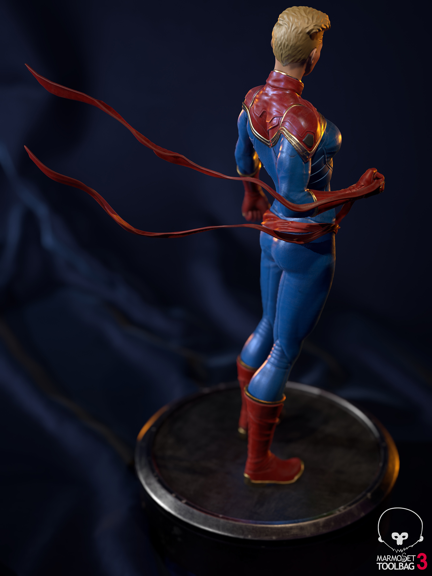

The environment is equally important at times. In some cases, it is good to a have small environment around the model. Can be helpful to get those bounce lights, really setting the scene.
For this piece, I wanted to go with a Collectible/Toy render a logical thing to do was to add a backdrop. It was easier to create as I had to just Simulate the cloth in Marvelous Designer and make it interact with the Pedestal/Base.
I know the Backdrop is kinda huge but It did help by adding some sweet bounce lights to the piece.
It’s obviously not possible to have the environment modeled every time but in time when its less tedious and less time consuming, it’s better to do it instead of just adding an Image/Backplate behind.
Once you combine all the lights, and you end up with Key light resulting in good highlights & shadows with rim lights capturing the silhouette and subtle fill light that helps to blend in all the pieces together.
