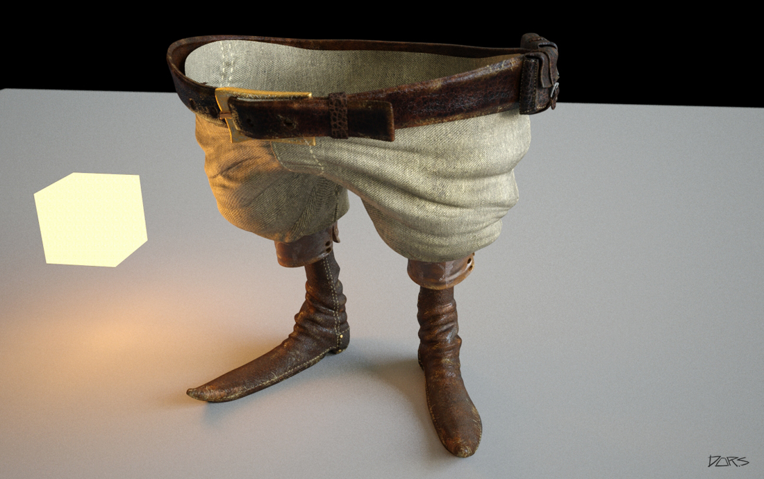

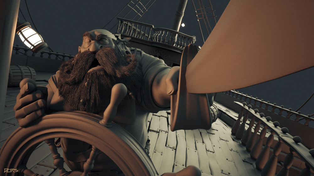

I’m adding 2 more WIP images.
one is the final scene clay render that you could see the clean meshes.
the other is a shading test of the boots and pants area, I think a few tweaks happend
till the final image but its preety much close to the final shaders.
enjoy.
