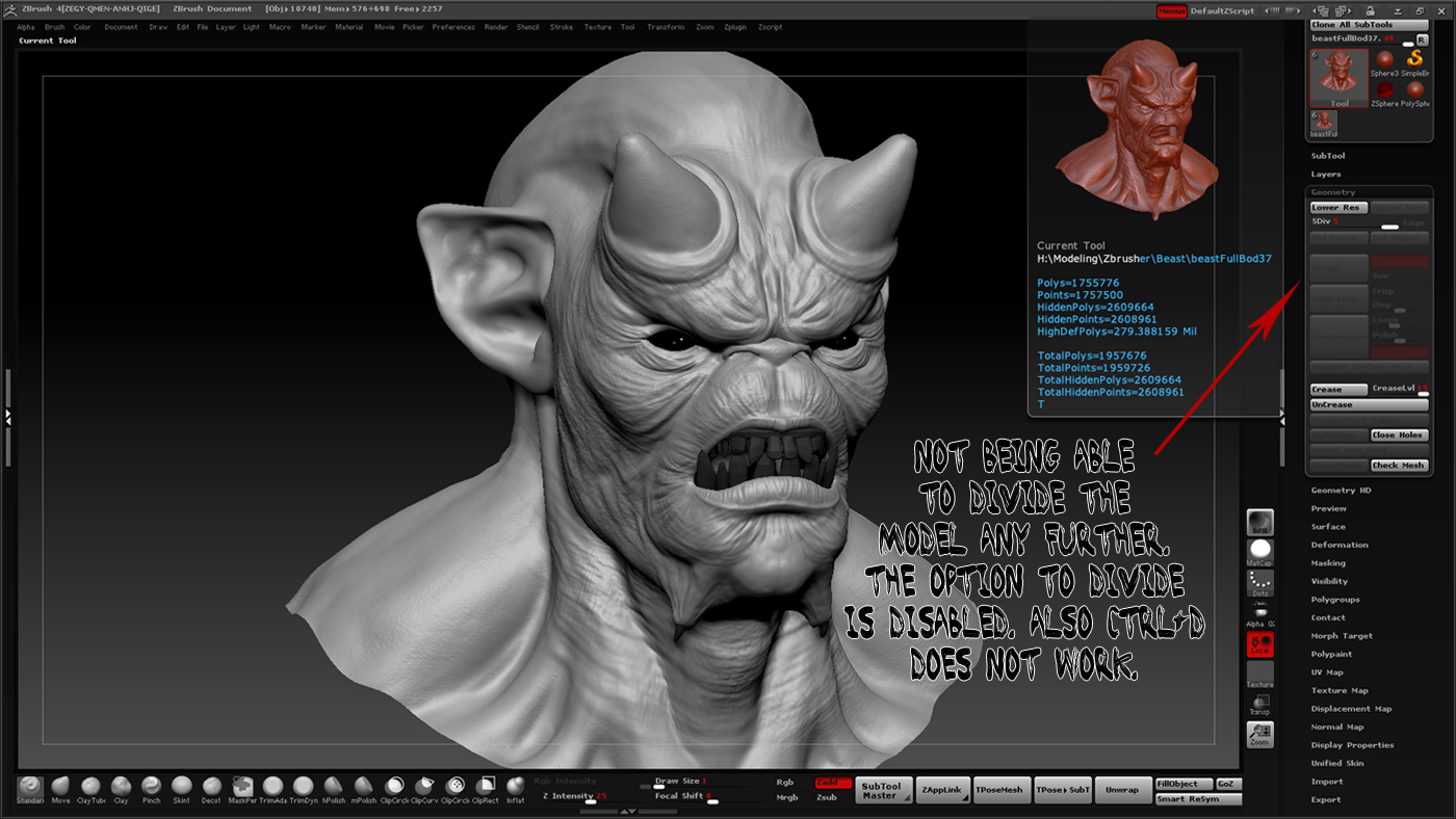

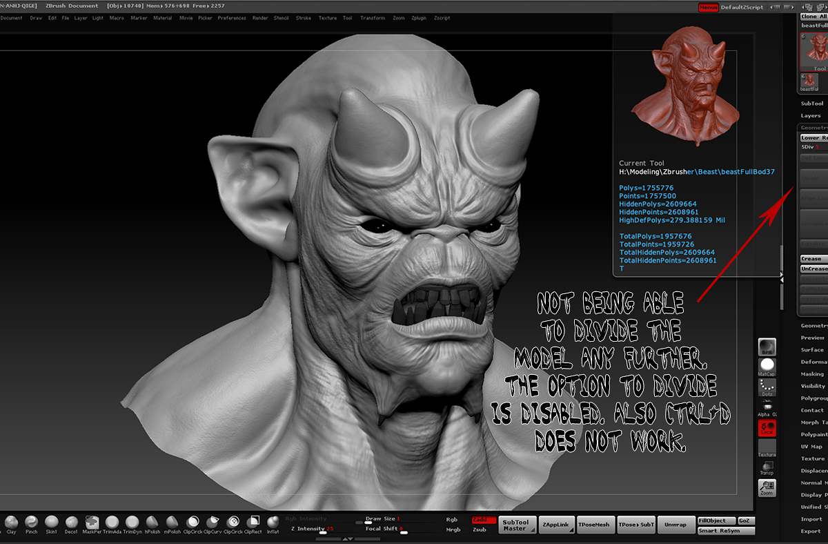

Hello friends. I am having this weird problem. The divide button is disabled. I can’t divide my model further. The whole model currently stands at around 4.5 million poly. I wanted to go up a division for detailing. The shortcut ctrl+d does not work either. Any idea what could be the issue?

Here is an image to better show the issue:
