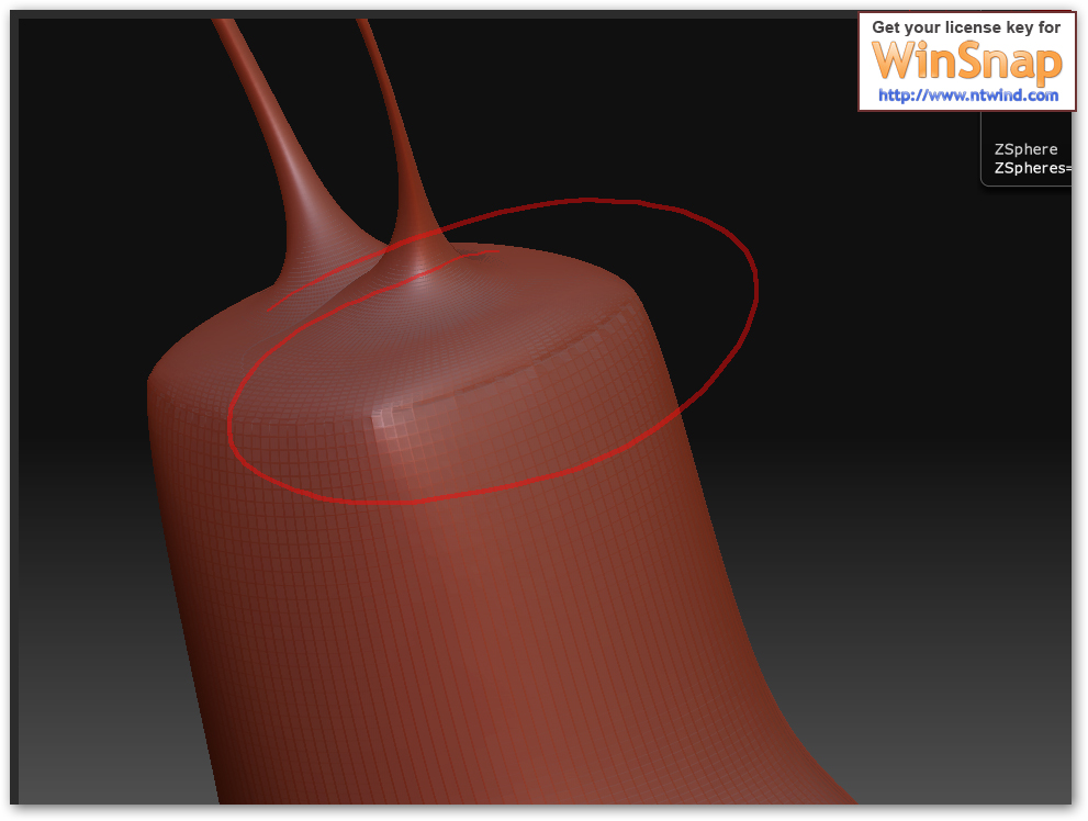

heyy everybody i am pretty new here and i am trying to model something out of z spheres and i cant do nothing about an edge that i get at the top at the very end of the head!how can i fix this?i am uploading file with it thanks in advance
My guess is that your parent ZSphere has two children coming off the same side of it. This doesn’t work unless you lower the Tool>Adaptive Skin>Ires setting.
thanks for the reply. i finally got the the iris settings and i put them down on 3 and everything else looks a bit better but not that piece. is in the same thing if i have fingers coming out of a palm? to me it looks the same. any way since i cant fix this i decided to add them later as a sub tool. I am not sure if this is good idea but i will give it a try. not sure how will i join them to the body later. And one more question if i am exporting sub tool is there a way to export them all together or i have to find way to do this in max for example? thanks again and good day
