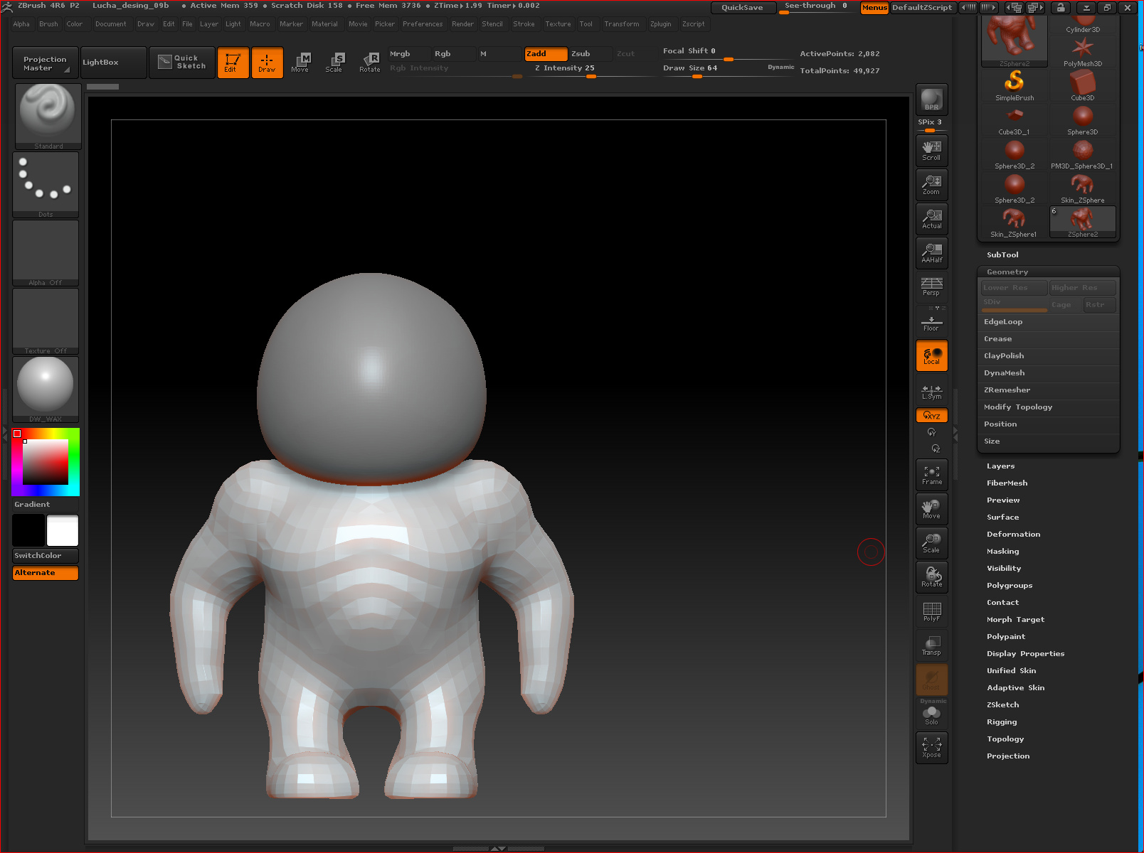

I second the call for a full screen interface screenshot that shows your program version in the top left corner, and the Tool> Geometry menu open for a mesh you can’t subdivde.
Ok Here is a screenshot
Looks like you didn’t convert your zspheres to a polymesh/adaptive skin before using dynamesh or zremesher. Hitting ‘A’ only acts as a preview and shouldn’t be sculpted on until you first convert it.
Thank Looks like you were right. When I go back to Adaptive skin it is on Preview…
