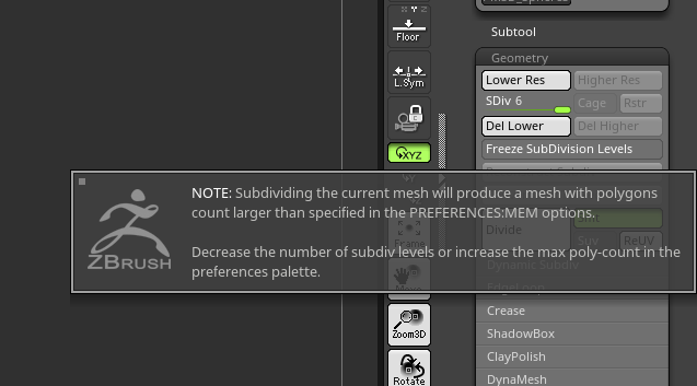

How long do you wait when you try to add level 6? Depending on your system, it could take a little while to compute that last level if polygon count is going to be high. Do you get the following message (see image)?
2022-01-13 13_45_04-ZBrush

To elaborate a bit on what ZBer2 has mentioned, I’ll just say that the most common reason for not being able to subdivide a mesh further is that it would result in a mesh over your max limit in Preferences> Mem. Every subdivision multiples your point count x4. If this would result in a mesh that exceeds your max setting, it will fail. Keep in mind that the maximum per subtool polycount in ZBrush is 100 mil polygons.
However, you really should be seeing a pop-up informing you that this is the case. If you are not seeing this, there may be an issue with the mesh.
Working at extreme polycount is performance intensive, and the subdivision at that level could take a short time, depending on system specs.
