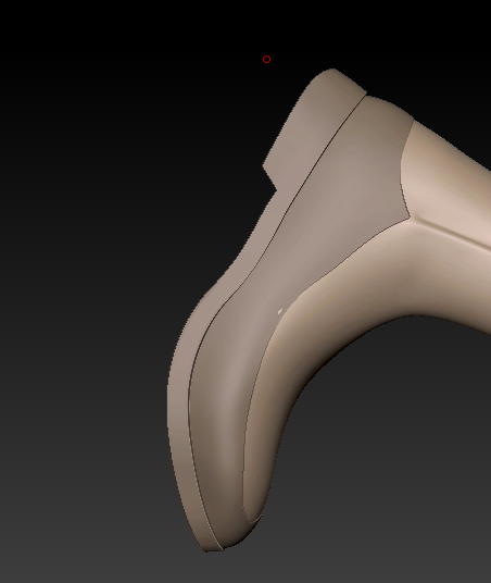

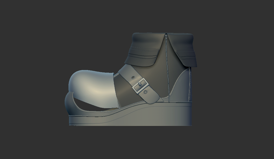

I created shoes.
I want to bend the tips of my shoes.
But,
There are many sub tools.
Is it possible to bend them at the same time?
I want to use a brush and a mask at the same time.

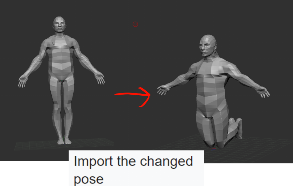

I refer to this function from the documentation linked above:
TPose > SubT
After posing the combined mesh, pressing the TPose>SubT button will transfer the pose to the original model, updating each of the SubTools.
