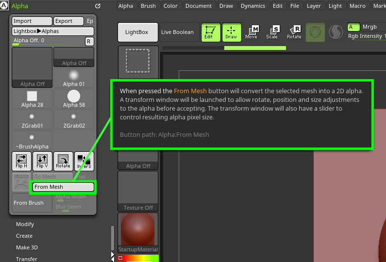

Hi @Huertaaj
You can also use “From Mesh” in the Alpha palette. It will export a PSD file with 16 bit depth and a maximum size of 2048x2048. If you need a larger size, you will have to change the Document to the size you desire and then use “GrabDoc” in “Alpha > Transfer” as Spyndel mentioned.
2021-10-15 12_05_57-Greenshot
