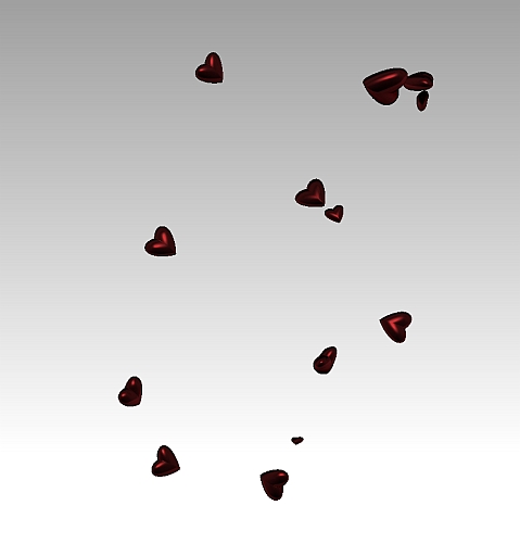

In my latest test, I carefully drew out a line and made sure the zspheres were all oriented in the same direction based on the shading and got this (there’s some pattern here, but I can’t figure out what influences it).

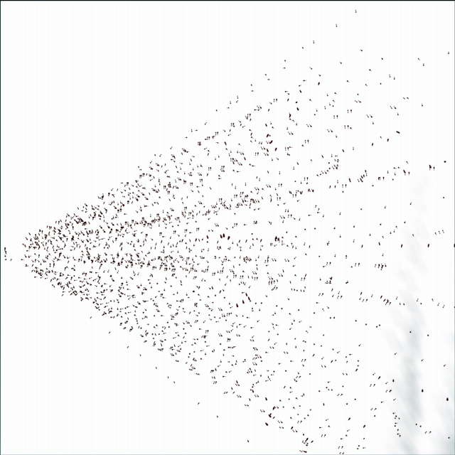

this is what i got from some careful straight lines and lots and lots of zpheres scaled way down… if u use a simple teardrop shaped double zsphere based polymesh as the object you can get some incredibly nice scatter fields for explosions
just to note… this is 375x6 particles… i cloned the original and rotated a few times… each particle is maybe 80-120 polys …forget exact amount

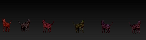

tried out using zsketch with the mesh insert plugin and i get a nice interesting effect… it doesnt quite work right but the effect it provides is very very very useful.
start with one zsphere… draw out a random zsketch , (i would assume try to keep it relatively small at first so as not to overwhlem the script. ) turn off the edit sketch mode and add another zsphere off of the main sphere of any size…(the plugin prompts you to select a working mesh if you dont)
with edit sketch still off run the plugin, and select any small obj to insert, and cancel at the next step…it will actually pick up the zsketch and try to insert at every point on the sketch… after it finishes loading something interesting happens… it doesnt insert the proper mesh into the zspheres… but it actually converts the zsketch into an editable set of zspheres… you can now drag them wherever… delete individual spheres. amd generally work on it like it was a regular set of zspheres and not a sketch… i can see using something like this to rough out the sketch of a item, run script and convert it to a much more refineable set of zspheres… and then bring the final product to a polymesh…
