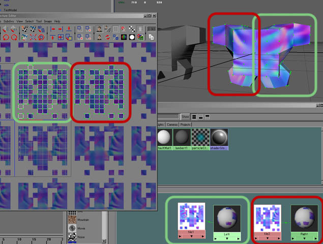

I have just tried the procedure. There is nothing wrong with it per se, though, as I`ve written in other threads, I like to have a two-poly deep rim of buffer polys at the open edges of the chopped off body parts.
This screenshot shows the model that was GUV tile mapped in ZB and re-imported into Maya, with the normal maps generated for each side assigned to separate materials and their respective polygons.
The lack of success you experienced may be Max pipeline specific. I can`t help there, only having Maya and LightWave to hand.
