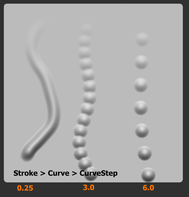

Hey all, I have created a curve and when I apply a stroke to it there are gaps in the stroke, the brush stamping isnt dense enough. After thoughrougly searching I can see no way to alter this. I thought there would be a setting analogous to lazy step somewhere? Any ideas?
Thanks Zber. I did mess with that setting but I was trying to change the spacing on an existing curve. Hopefully I will get the result I desire with a lower setting on a new curve!
Just an added note. When using CurveStep slider, the higher the value, the more Z Intensity that is needed, and less Z Intensity when there is a lower value. I don’t know why it does that. Just the nature of the beast I guess. Default CurveStep value is 0.25.
