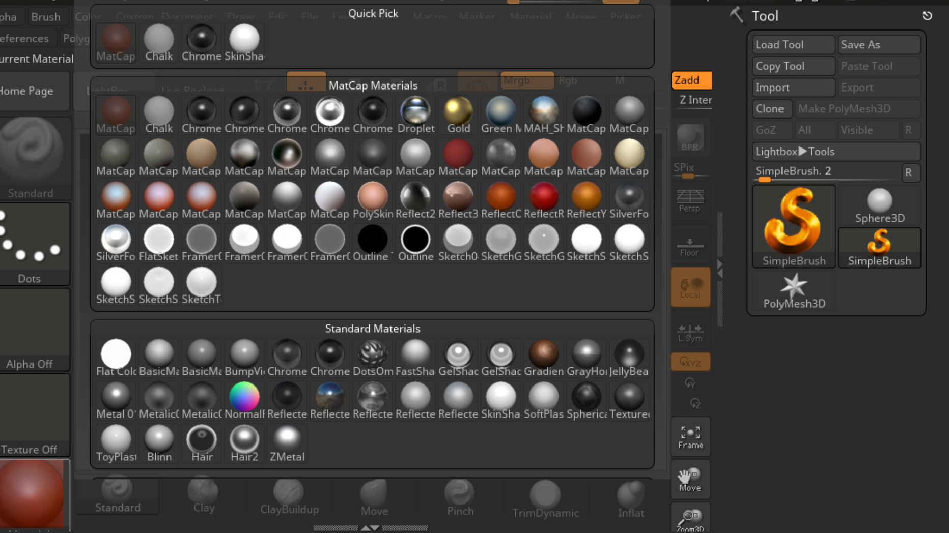

Hi all, I am attempting to follow along a course from Pluralsight titled: Rendering Enhancements in ZBrush 4. I am using Zbrush 4R8, and one of the lessons is titled: Using the Fresnel overlay material in Zbrush. I cannot seem to find this material anywhere, it’s not in the default materials or when I search in lightbox. I also can’t find any download link online. Did they remove the material for 4R8, or maybe I’m just missing something? Any suggestions or help would be greatly appreciated! Thanks!
Bottom of Standard Materials palette. Are you using 4R8 P2 ?

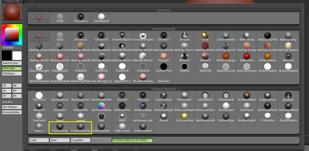

Attached is a screenshot of my standard materials palette. I feel like I might be missing P2? Thanks for your quick response!

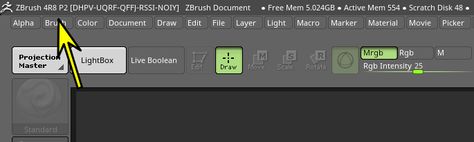

The version number is in the upper left corner. I know P2 fixed some missing materials in the previous version, but I thought they were just the DoubleShader, TriShader and QuadShader. Looks like you are running at too low of a screen resolution also. Minimum is 1280 x 1024. That might have something to do with it.
Updating to P2 fixed it for me, thank you so much! As for the screen resolution I just lowered it because my original 3000 by 2000 screenshot was too big to upload to the forum. Thanks again!
