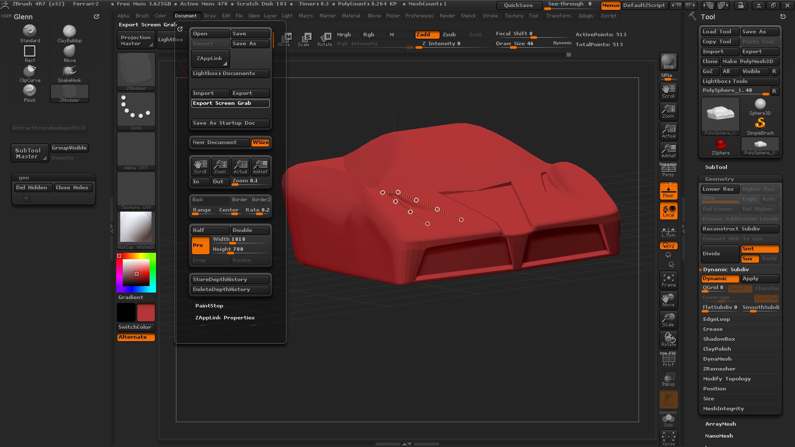

It is mostly just a nuisance, any help would be appreciated. Trying new ways of doing stuff and I could only use the curves on one side so they did not even work for what I wanted. Go figure.

PS. I’m not sure to have understood you. But if you have meant both sides. Then make:
A.) Set your created polygrouparea also on the other side with the Mirrow and Weld function:
Tool > Modifiy Topology > Mirror And Weld. And you receive the same created polygroup area at the other mirror side of your model.
B.) Or: created by hand your curves also on the other side, like in your image is to see. Hmm…
