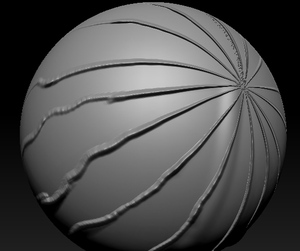

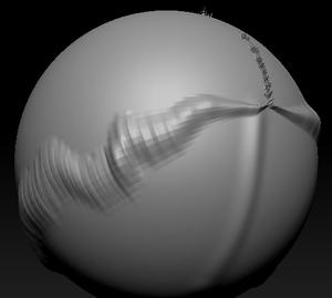

To the subject - if I whant to fix the displacement as the geometry - there is the button “Apply DispMap”, But when I puch it - the displace unfortunately doesnt work good - is it dont understant tiles. Please, see screens:

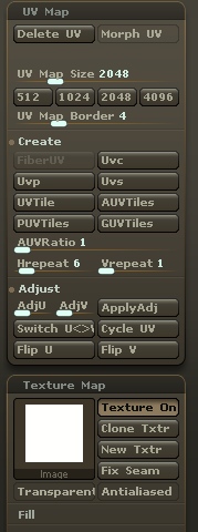

The UV Map>H Repeat and V Repeat sliders are display only. You need to ‘fix’ them as your UVs before the displacement will work correctly. To do this:
Thank you, marcus, for the answer. Now, it is working throught export-import process!
But u forget to say about dividing the model after importing it.
