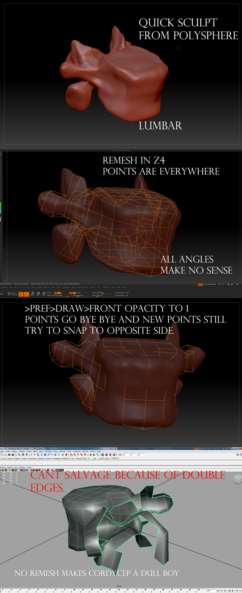

I know this is saying a lot but I don’t see a point in having a mesh that is totally transparent and allows you to see the entire remesh at all times. It makes trying to draw new points almost impossible since it’s trying to snap all over the place. Even if you turn “front opacity” to 1 under preferences/draw, (the mesh turns back to a solid color), the remesh points now become hidden under the selected mesh, so now you can’t see your points and the new points you try to draw are still trying to snap to the other side.
Maybe someone knows a fix? I never had this problem in Z3.5r3, and I remeshed like crazy on that. P.s. I’m not about to buy NEX or Topogun either.

trust me I tried it. This is what I mean.
Ya, there is no fix for this in ZB4 right now. Marcus civis knows about the issue and I believe has forwarded it to the developers. Your best bet right now, and a lot of people agree with this, is to use the appended zsphere method that is in the link I gave you. I voiced the same issue in a thread a while back. You can check the thread out here if you want.
