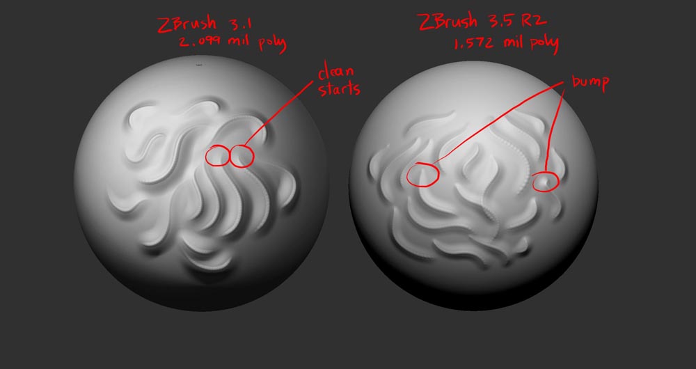

I want to expand on the point brought up by Lucky_1 about the bump at the beginning of the Standard Brush stroke. Much of the subtlety of the 3.1 brush is now gone. I’ve tried all sorts of adjustments including raising the depth but I can’t seem to achieve the same stroke as in the earlier version. To illustrate, I’ve included a screenshot below. The little dots at the beginning of each stroke, on their own, aren’t so bad but when your whole sculpt is covered with them it’s very annoying.
Don’t get me wrong. I totally appreciate all the effort at Pixo to deliver a better product. I also understand that the new brushes are more precise and “smart” and have a lot more settings to be experimented with. However, shouldn’t the Standard Brush (being the most important) be usable right out of the box without any adjustments?
