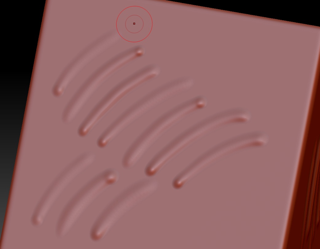

Hi guys, got a little issue.
When i stroke, say with a standard brush, and with my wacom tablet, i always get stamp marks of the brush right at the begining and right at the end. It s just not a uniform stroke as it should be. The only way to correct this, and have a nice and uniform stroke is when i turn lazy mouse ON, even with a value of 1.
Can someone explain me, please, why without lazy mouse i cant get a uniform stroke, without those starting and ending little stamps? The stroke is higher at the ends. In mudbox, this doesnt happen, with or without lazy mouse.
I tried all possible settings i could think of, but could not fix this. If i use mouse without lazy mouse, the stroke is uniform as it should be. With PEN, no.
Thank you.

I think really it must be some setting, or it s how zbrush really behaves without lazy mouse and pens. With mouse everything is fine. When lazy mouse is off, the build up of the brush is way stronger, i dont understand why, if i am aplying the same pressure, when using pen.It s quite a huge difference in surface protrusion.
Here are 2 pics.
http://s23.postimg.org/aqykpq257/pic1.jpg
http://s27.postimg.org/yn7g7z5hv/pic2.jpg

well I’ve got nothing. I’d put in a support ticket for it. All I know is it shouldn’t be doing that.

This marks can actually make sense, because 1stt time u touch tablet and when u lift up, there must be a pressure variation. but there should be also some damping function to counter act this.
