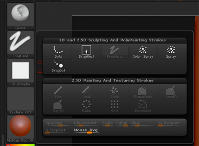

Brush spacing issue?
So I’m trying to get the spacing on my brushes set so that everything’s closer together (the brush stroke isn’t spaced apart). Ie: I’m trying to use the claytubes/gouge/etc brushes, and instead of being 1 long stroke, it’s made up of a ton of individual squares… and requires an immense amount of smoothing over afterwards instead of not having to do that to begin with. I go to my draw menu and spacing is grey’d out so that I can’t even select it to change the spacing. To say this is frustrating is a bit of an understatement…
Any ideas on how I can change this so that I actually have the choice in setting the spacing up how it should be so that the clay tubes is flat and not made up of a bunch of squares?
Thanks in advance,
Helix
switch the stroke from “dots” to “freehand”
I already tried that and nothing happens… see below:
