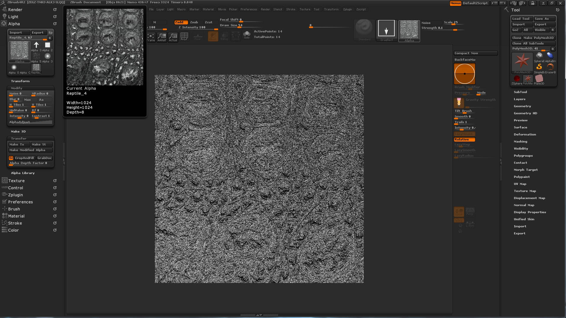

Either way, by the sliders on top of the interface or by the spacebar. The brush size won’t change. I’m having a few problems with ZB through the tutorial. The Alpha import looks OK in the preview window but looks like hell on the 2.5 canvas. (As shown in the SC.) If I do it through the texture pallet and crop and fill it looks OK. Also I made the image 16 Bit but yet was still coming in at the original 32. I changed it 8 and now it comes in at 8… Strange. I got the Lizard Skin from CGTextures, then just Grey Scaled it and saved it as 16Bit in PS.

Oops forgot the screen shot.

There’s a known issue in 4R2 when trying to adjust the Draw Size for 2.5D work. You need to put a mesh (the PolyMesh3D Star will do) into Edit mode first, then all will be OK.
OK, thx marcus. As soon as I can get back in ZB I’ll check it out.
