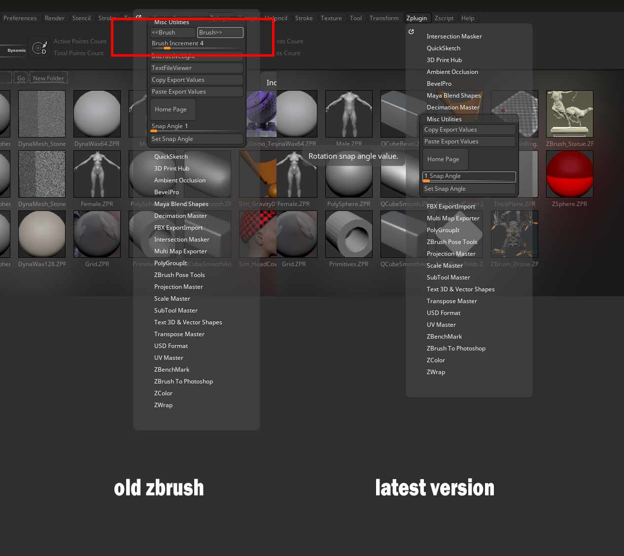

After updating to the latest version of ZBrush 2025.2, the bracket keys for adjusting brush size no longer works. The controls under Misc Utilities have also disappeared. Anyone faced this problem?
I updated to latest patch on two different devices, and I now have the same issue - can’t adjust the brush size using [ or ]
Same problem … 2025.2

There has been an oversight with the newest release where a couple of plugin files were overlooked and didn’t make it into the software.
I have attached the HotKeyDrawSize.zsc file and InteractiveLight.zsc file to this response. You will want to copy them into the ZData/ZPlugs64 folder of your ZBrush installation.
By default that folder is located at C: > Program Files > Maxon ZBrush 2025 > ZData > ZPlugs64. "
I have attached the 2 zsc files incase you guys don’t want to submit a help ticket. I have tested it and the shortcuts works again.

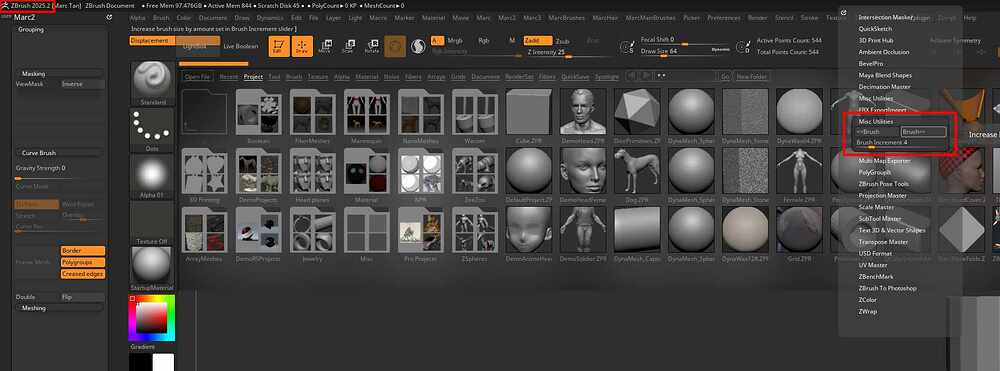

Thanks! It works now
Steve
Same issue here
my draw size is greyd out on 2026.1.1
