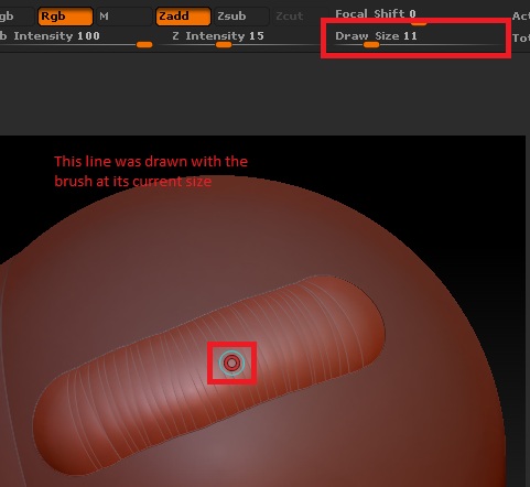

Okay, problem is reoccurring.

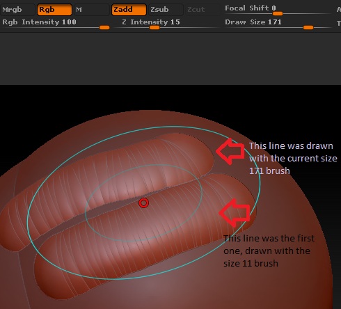

In case you can’t read the text, the first image was a line drawn with a size 11 brush. The second image is the first line (the bottom line) with a line drawn next to it with a size 171 brush. As you can see, the tool size has changed, but the size of the physical line hasn’t.
So, as close as I can tell from your image, you’re in ZSketch, EditSketch enabled. What stroke type? Do you have ZB4R4 P2?
Sketch 1 is the brush thing I have selected, and I’m only using ZB4R2.
Check for an update, that might fix your issue.
Okay, I’ll give it a go.
Thank you! It’s working well so far :slight_smile:
