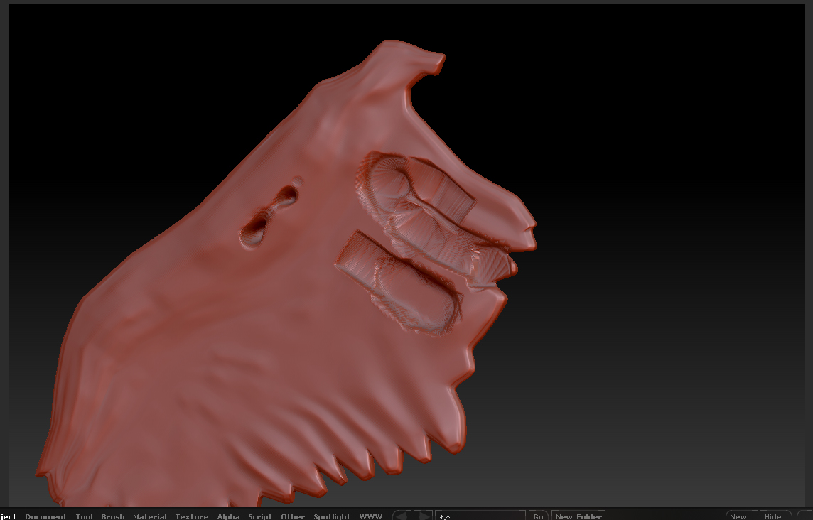

I’ ve had this problem for past few days with one of my models.
I started sculpting a wing using practically any brush, i got really into it but then, i turned the model around and noticed i effected the other side with my brush strokes.
I wanted to know if anyone has any clue on how i can avoid this problem?
this image that i’ ve posted is the effected side!
Thanks
Frank
In the ‘Brush’ menu, under ‘Auto Masking’, turn on ‘BackfaceMask’
I’ve run into this problem before, the backface mask should do the trick. I think that happens when the brush size is larger than the thickness of the model.
Thanks zber2!! this works !!
