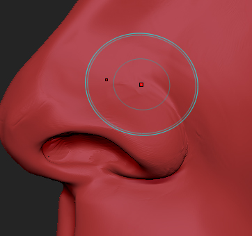

hi, my problem is with zb 4 r2, my brush cursor continually turns light blue and i cant see the size of the actual brush, and when i try to resize it, it is resizing the light blue radius which has nothing to do with what im doing. can anyone help me know what is going on here? ( i am not activating smooth with this)
also i just noticed it only happens on certain parts of my mesh.
The light blue cursor is the Curve Edit cursor. Can you post an image of the problem?
so my actual brush size here is 100 and its showing up as that small. what is weird is that it is popping up on random parts of the mesh only. i have not used any curves on this ztl

Ran into the same problem this morning. There’s just a spot on my mesh where the brush turns from red to pale blue. The pale blue area has different draw size, focal shift and lazy mouse setting which can be altered with hotkeys. There’s no indication that I can see that would make the small patch of polys different to the rest of the model. I don’t think I’ve used the curve brushes on this particular model.
EDIT: It seems to be a glitch in the layers. I’ve got 5 layers on my object. If I select any of the first 4 layers, the model turns black. If I select the layer that I’m working on - the 5th one, the model turns black except where the pale blue brush area is. Turning this layer off makes the non-black area disappear but the brush still turns blue when hovering over it. I can flood fill back to the correct colour however the pale blue brush area remains.
EDIT: Fixed it with the help of a fellow from Polycount. As it turns out there was a tiny, curve on my mesh which was invisible with the brushes I was using. Opening the stroke menu, and turning on the curve tool revealed the curve which I then removed by clicking delete. Not sure if there’s a bug here or not.

you have to open the stroke pallet, turn on the curve button, delete the curve, then turn off the curve button. That stops the cursor turning blue and changing size. but it is very frustrating.
Im pretty sure this happend to me because I used the curve on another subtool in the same set… anyway heres the pics to help anyone who dosent get it from the descriptions.
