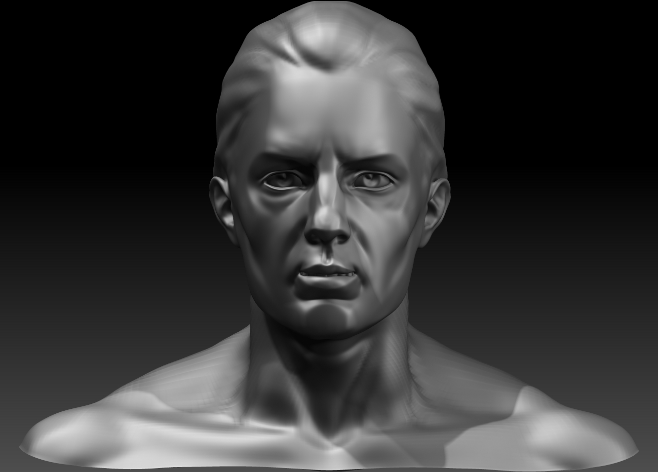

Try this project. It includes a LightCap. Just render it with BPR “out of the box”. See how it compares with the render I get.
https://www.dropbox.com/s/g5g1sl5ptr0uyv7/DemoHead-LightCap.zip
Any chance any of you guys can take a screen shot of a basic lightcap setup on your end so I can rule out if possibly if it’s a glitch in my program, or maybe hardware or something? A two light setup seems to be when the issue shows up the most. thanks!
thanks Marcus - the link doesn’t seem to be working however. I just get a “problem loading page”. suggestions?
What browser are you using? You should be able to right click and do a save as.
Apologies, there was an extra ‘http’ in the link. Please try again.
