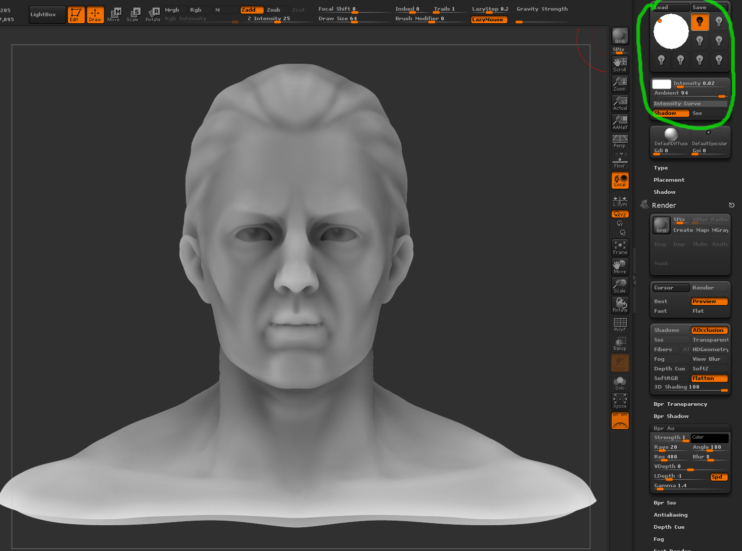

This is rendered in zb4.0 and uses the basic material. Notice that I’ve turned the one light down to intensity of 0 and ambient up to around 60. Perfect results!
Here is another render from 4.0 using the flat color shader with AO on in BPR. Once again, just as you would expect.

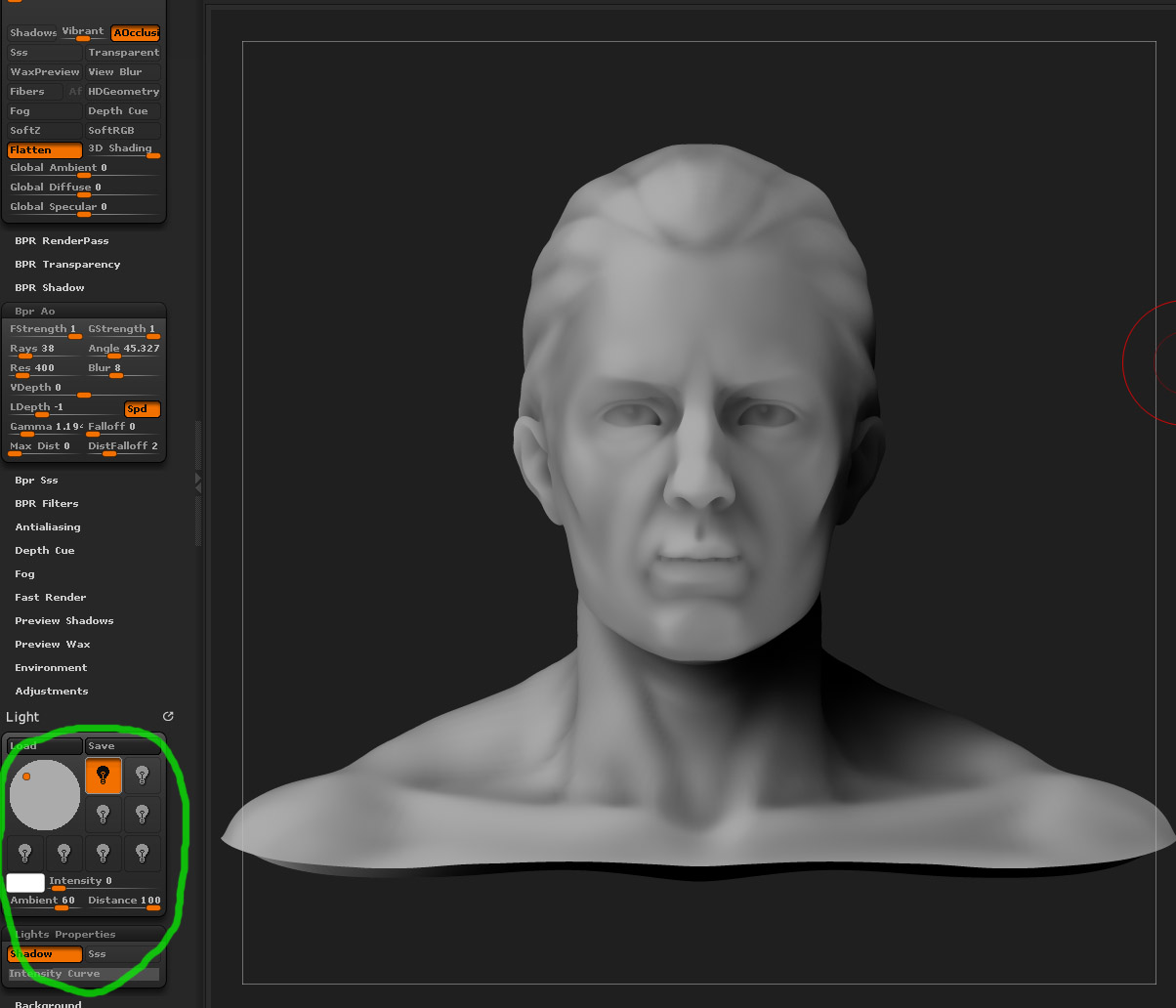

This one if from 4R6 and shows how the main light source has a HUGE impact on the AO…even though it is set to Intensity of ZERO and the ambient is up at 60.
