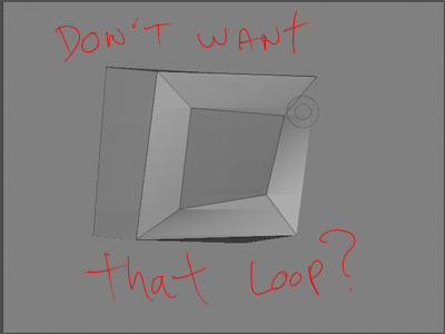

I wonder if the following actions are possible with ZBrush :
I would like to divide the faces on the top, and only on the width, I don’t want the length to be subdivided as well. Is that possible ?
Thanks in advance !!
You’re asking for point modeling features in a program that was designed for organic modeling. There really isn’t a way in ZBrush to do the vast majority of what you’re asking for; specifically because ZBrush was designed to free you from such concerns.
For example, the shape that you’re looking for in question 4 could very easily be accomplished in a matter of moments with ZSpheres – and not a bit of “traditional” polygon modeling being necessary to get there.
In other words, “think outside the box.” :wink:

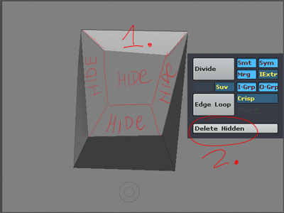

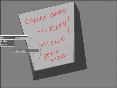

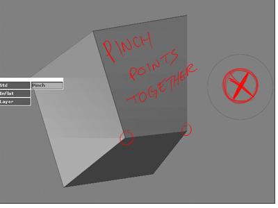

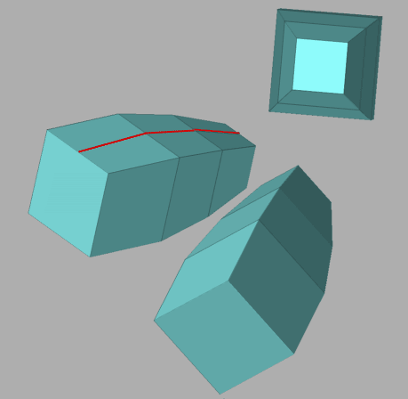

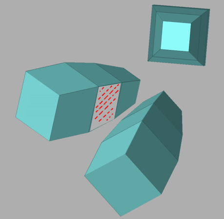

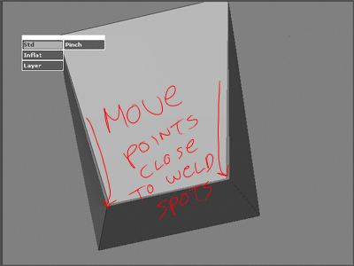

Here’s something I unraveled while practicing my poly modeling. I hope this helps.
6.Export the object and save it. Reimport your saved object with a suitable weld ratio, and they should be welded.
