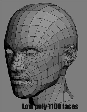

here’s the lowpoly cage out of Max for those who are interested:
[attach=10934]low01.jpg[/attach]

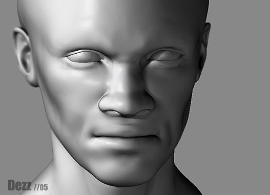

I’ve got a question for you guys,
as you can see I did the eye on the same mesh in Zbrush, I realize now the error I did… I got too fast on this… damn me
Is there a way to remove some faces so I can leave holes in the eye area ?
I can’t find it :mad:
if they are groups by themselves it would be easiest…ctrl-shift click on them to make em the only things visible, turn on doublesided to make sure no other head parts are visible then ctrl shift drag outside your model to make the head visible, rotate it around to make sure no poly’s other than the ones you want to get rid of are gone then go to tools-geometry and delete hidden.
if they are not grouped already…you could go several ways…one would be to use masking the area you want gone, inverting the mask and using hidepts in the masking menu to see if that hid everything you want gone then go to tools geo delete.
I would probably turn on double sided, carefully use the select hide features to select the eye parts I want toget rid of…first by select what I can of them and using the group visible feature in tools polygroups …adding pieces I missed til I was sure I got them all…Look it over with the eye groups visible and not visible to make sure I was satisfied then use the first step from above.
someone probably has an easier way tho…i am a bit of a nut and don’t always do things the easy way.

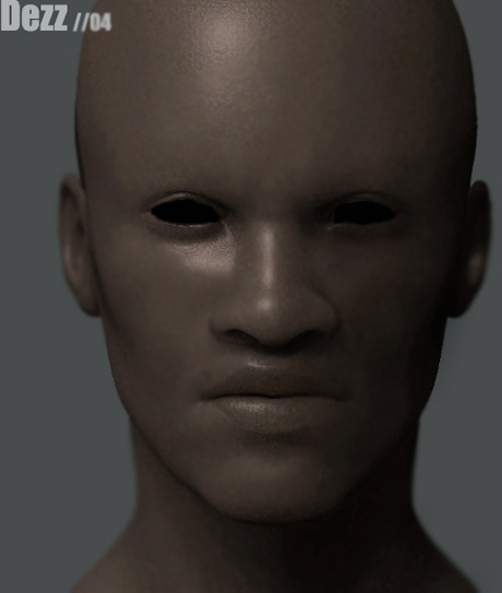

update…
Skillfully done. Nice
The black guy is looking goood!
