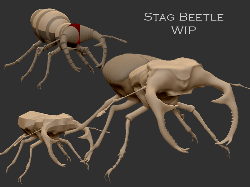

I´m pretty new to this and I´m challeging myself to try to make a stag beetle.
If you have ever seen one of these creatures they have like a ledge (is that the right word? of fold on the edge of the plates covering the wings and I have trouble getting that to happen.

Post a close up of the edge. I would say mask the edge off and then invert the mask in the masking panel. At that point you could maybe use the transpose feature to bend it, or you could inflate the whole edge and afterwards go underneath it and use the smooth brush to knock back the underside lip.

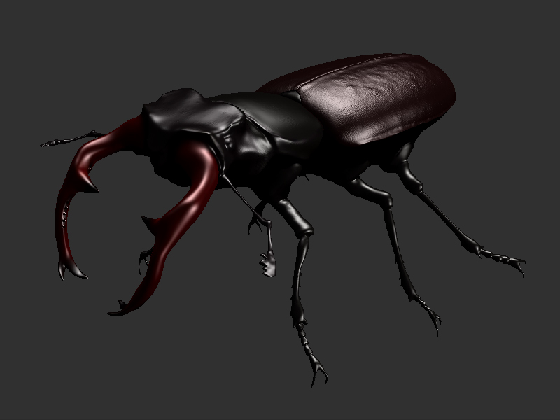

What I ended up with was making an inverse mask around the edge and used the pinch tool. it kind of worked even though it didn´t exactly turn out like I wanted but hey, I´m still doodling and learning : )
This is how it look at the moment:
Sweet, it came out great. Did you adjust the brush modifier so it would pull towards you as you pinched? I have advise for polypainting your models to look more earthy and alive. Do an underpainting over the entire model using bright colors. For flesh I’ll do yellow, red and blue (painting them in the apropriate places). For bugs you could throw some purple in there. Joints tend to be redish, fatty areas yellow, and pits where there is lots of veins (like around the eyes or armpits) are blue. Then using the spray stroke type paint in the main colors your going to use for each section slowly. Set your RGB setting low like 10. The key is to cover it all but let it tint the layer you paint over it. The end result feels warmer and less plasticy. I learned this technique for 2D digital art and doing flesh tones, but have since used it on 3D models of green skinned monsters and it works just as good.

Maybe some ridges down the length of the main pincers so they don’t look so perfectly round, and a little more shape to the head crest. I’m not looking at a pic of a stag beetle at the moment so it’s hard to say. Sometimes things fall into place if you use the rake brush to rough in some shape and then go back over it with the smooth brush (just by holding down alt).

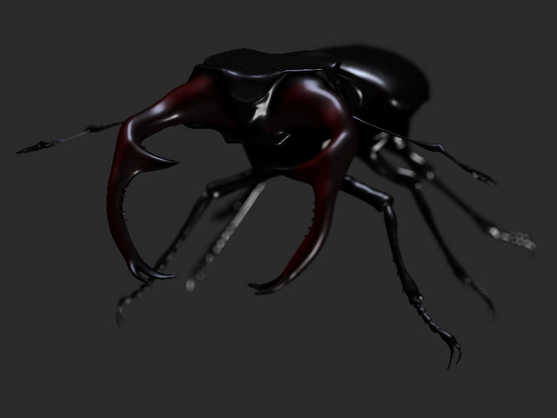

Imade a render in ZBrush and put a lens blur on it. I will try to get some more details in it eventually.
