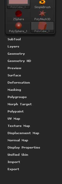

I have a question about this “initialize”.
I have 3.5r2 and going along with the tutorial on using the Projection master here on pixo’s site.
Why does my version NOT have “Initialize” as a tool option??? Please help!
A screeny of my tool section:
