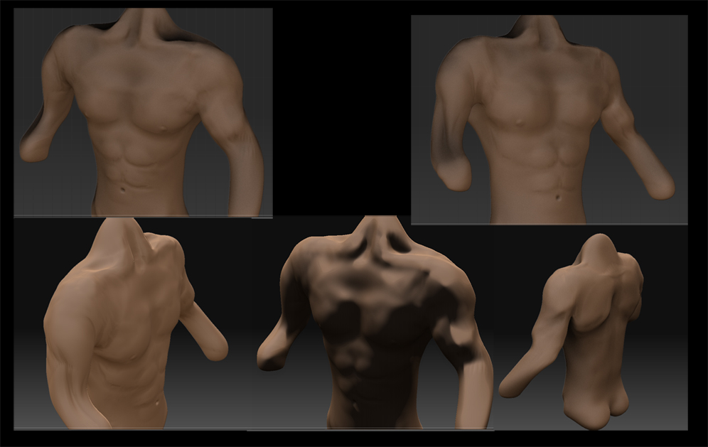

After MANY attempts over the last few months at anything in Zbrush, I finally decided to re-install my copy and try one more time.
I ended up making a male chest, from ZSpheres. It took a few hours getting used to it and making it. It’s my first model so C&C please, you guys rock:)
It’s still a WIP so pay no attention to the arms, or that it’s lacking any proper detail:)
[Untitled-1.jpg](javascript:zb_insimg(‘163478’,‘Untitled-1.jpg’,1,0))
glad u didnt give up! zbrush is a very powerful tool and clearly there is a learning curve. i am a newb myself and learning as i go but i have been in the industry for a while so i am not new to 3d. looking at ur model, it seems like ur sculpting is pretty good…the main concerns are more with the anatomy of the bust. i would recommend keeping a good anatomy book handy to study muscles and bone structure. you are on the right track so keep it up!
My main problem was the chest area, you’re right. Thanks for the comment :slight_smile:

as far as your sculpt goes… i was in the same boat yesterday… trying to get responses, being a beginner myself. what was suggested to me which helped TREMENDOUSLY! was go get some muscle anatomy references (preferably one that names the muscles on it), and just go in and start sculpting out the shape of the muscles with the clay tubes brush (and alpha 06 seems to work best with it). but dont do that at your highest subdivision level.
start from level 1, and just brush out the shapes of the muscle. you wont notice any change but the program will pick up what you are doing. after subd 1 move to 2… and repeat. i did this all the way to subd level 5. afterwards you can take the smooth brush on a low intensity and just start smoothing out the peaks and valleys.
also… when you get your shape down… check it with a flat shader, so you can tell how your silouhette looks. you dont want to start sculpting immense ammounts of detail on a badly shaped model.
