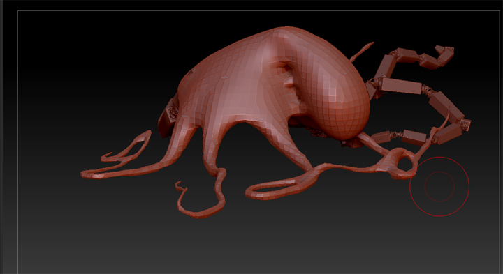

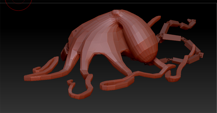

I created my base mesh in Maya and imported it into ZBrush. I am having a problem when I try to apply a dynamesh to it.
I made sure that non of my geometry was intersecting but for some reason my mesh is combining in places I don’t want it to. What is my issue here?
Thanks in advance for your help.
This usually happens if you have the resolution of the dynamesh set to a lower res. It shouldn’t happen when you set the res slider to a higher res.
That doesn’t seem to do anything. I cranked it all the way up to level 6. Any other ideas?
I upped the res and it worked. Thanks a lot!
