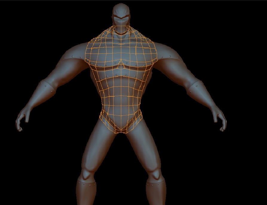

Hey thanks for the responses guys but I think the issue is directly related to retopology. Heres an image of the issue:
For some reason if I follow your instruction the wireframe dissapears slightly ‘into’ the mesh and the verts that i can’t see are still selectable. When I have used retopology before The verts that aren’t visible aren’t selectable either. I’m not sure what happened.

The points you can’t see are not selectable. The cursor is only snapping to those points.
Well, you also have the option of using the Appended ZSphere Method which is probably the prefered method right now anyway.
I always use the “append zsphere as a subtool” method because changing the draw size does make the topology lines sink into the mesh a bit, making it hard to see in a different way. :eek:
Unfortunately, the curser isnt just snapping to those points, they are also selectable making it next to impossible retopologise the entire character.

When you are in retopology mode and are using the ctl key to set the draw point often times an invisible masking of points gets set.
So anytime you find you can’t connect or move points try holding down LMB while holding ctl and drag in an empty space on the canvas to clear the invisible mask.
Edit: I’m sorry, I read that post as “Isn’t snapping” rather then Isn’t just snapping.
I think you are best to just start over by appending a zsphere as a subtool, select the zsphere and then go to the topology subtool and hit retopologize. Doing it the otherway has always been a nightmare for me in ZB 4.0, even with the draw size adjusted. The other way is a breeze…just use the projection feature in the subtool menu as the projection button at the bottom of the list won’t be accessible with this method.
Also if you are afraid of losing you work so far by switching to the other method, you don’t have to lose it.
In the state it is in now, hit “A” to see the adaptive skin preview, then hit “make polymesh” to send the work you have done so far into the tool box.
