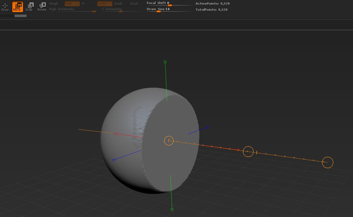

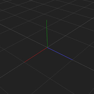

But what I’m looking for are axes like these, the world axes that are normal to the floors/planes
Most of the time I don’t need to see any other floor than the y-floor, but it’s nice to know which way is x and z relative.

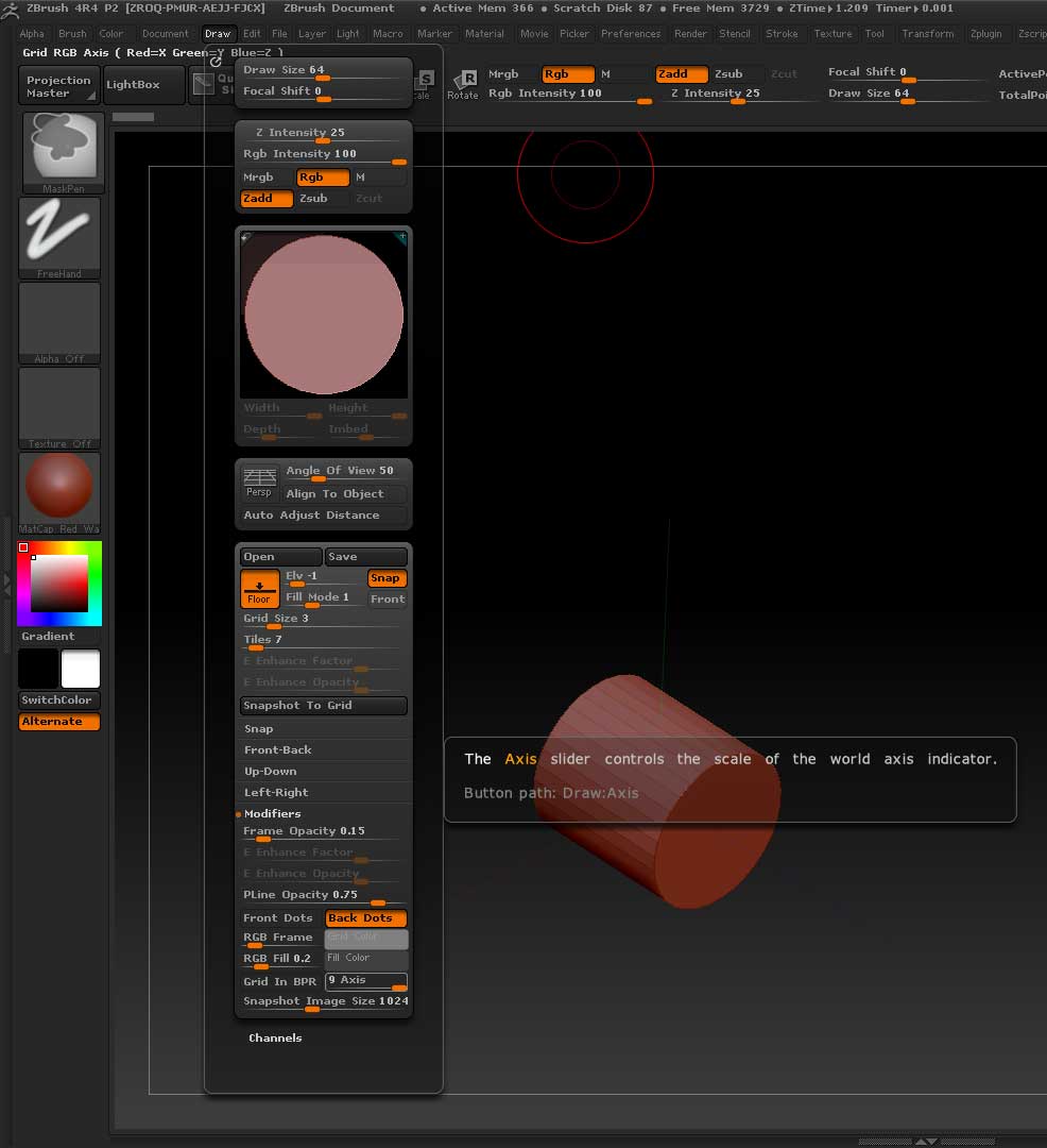

You can change the scale of the world axis in the draw menue. In my opinion they are very thin in R4 and I don´t see an option to change that.
ah, indeed they are thin, but thanks for finding that slider!
You can turn on the floor grid for all three axes (click the little X Y Z inside the Floor button - turning it off will show the letters better). This will then show thicker axis lines. To position the grids at the origin set the Elv slider to 0. You can also color the grids if you want by setting the Fill Mode slider to 1 or 2.
