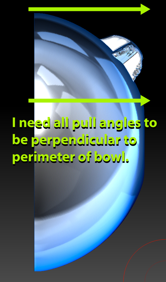

I am aware that this question has been asked in this thread http://www.zbrushcentral.com/showthread.php?t=93259&highlight=picker+orientation and possibly in others. I have read through several and not found a solution.

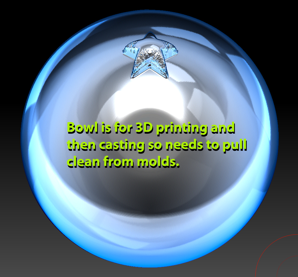

I want to be able to pull alphas with all edges straight down towards the bottom of a bowl so that all extrusions/edges are perpendicular to the perimeter of the bowl. This is so that a 3D print of the bowl can be cast in metal, and when cast will pull free properly from its molds. Although it is possible for the metal casting people to construct molds in more than two parts, it is best for this project to have only two molds (top and bottom).
Could someone please explain the process for accomplishing this? (The star is just an example.)
Thanks.

I tried using the alpha as a mask but it doesn’t give acceptable definition. The inflate tool does much better, but I can’t get the picker orientation to pull the inflate perfectly perpendicular.

Thanks - I tried that too but still not able to pull in the direction along axis. The thing is when the physical mold is pulled from the cast metal it needs to pull free without any hooks. So the extrude has to be all in one direction.
