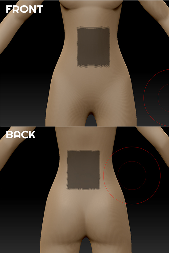

Okay so, I’m trying to use the MaskRectangle on my mesh, but it keeps getting drawn on the other side. Turning on BackfaceMask doesn’t seem to do anything. Does anyone know how to get this to work? Image is attached.
Backface masking doesn’t work with drag rect or the lassos. For this particular shape, it would be quicker to switch to the masking pen and manually unmask the back .
