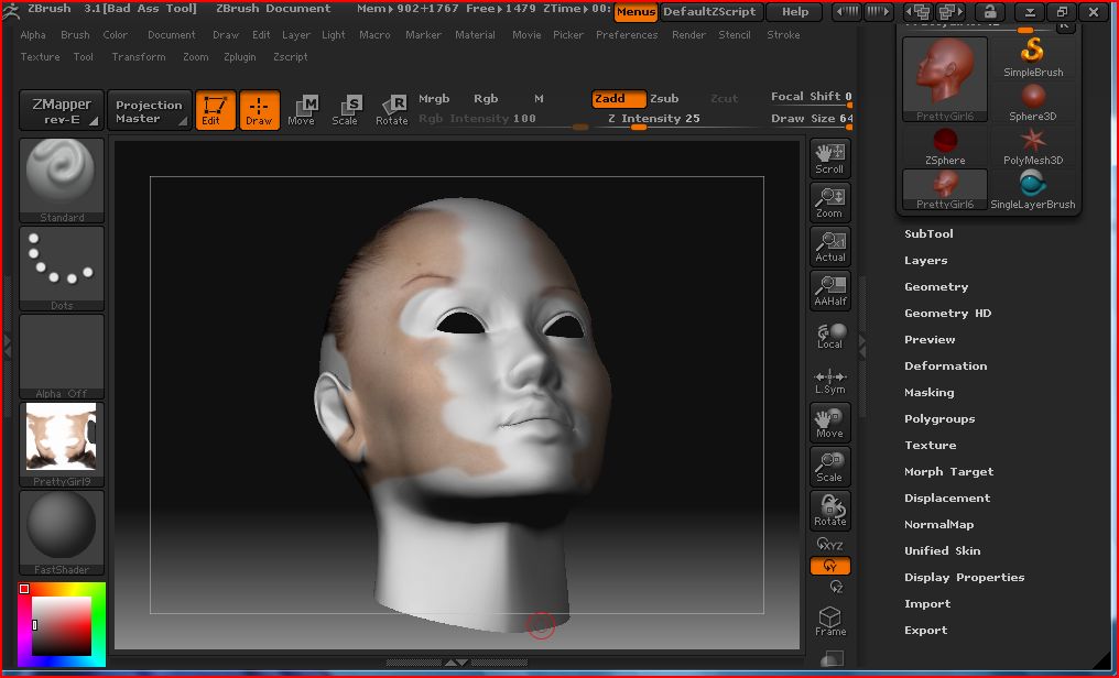

Never mind. Answer to my specific problem found. Facegen Imported .obj, following the tutorial in italian. I don’t know what it means. All I know is that it works now. When I pick up from projection master, it looks like it should, (at this stage) Pic included.
