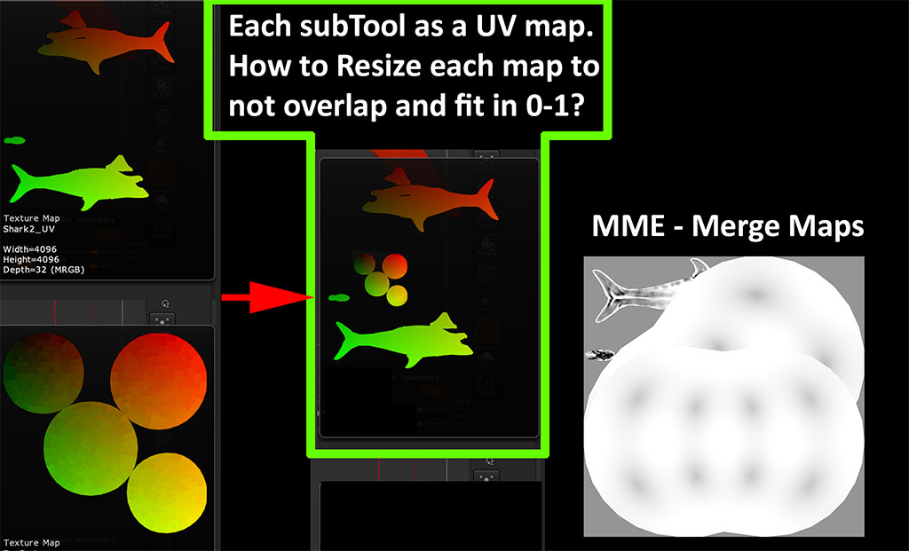

Is/How to arrange Multiple subTools and each of their UV maps inside ZB?
example:
When Using MME, they are not “fitting” inside 0-1 space.
example:
If you can’t edit the UVs externally and update them back with GoZ, then you may have to merge the tools together before using UV Master again (you can toggle it to preserve the existing seams). This will cause it to pack the UVs together without overlapping them. Then you can split them back into subtools if they’re still required.
yep, that’s it! Thanks!
