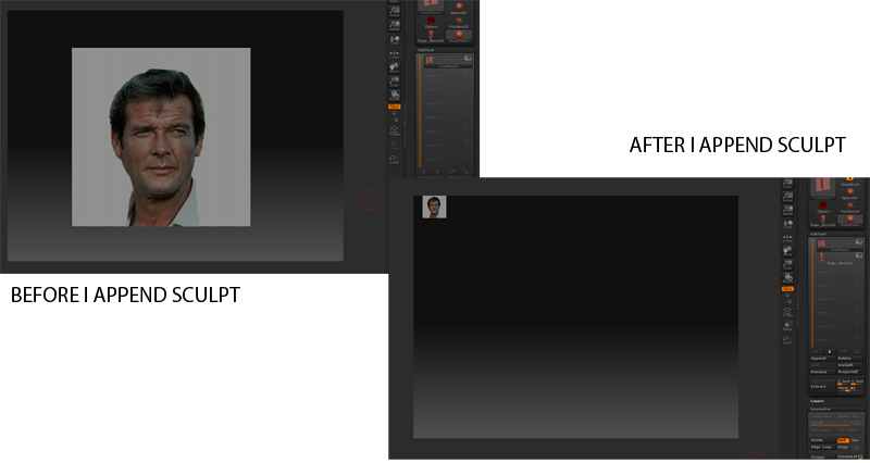

Append sculpt to image plane problem
I have been trying to append a half made sculpt of a head to an imageplane in zbrush, but every time i do this it offsets my image plane to a far corner and my sculpt is not visible, when I try to zoom into the image plane or pan around its as if it is orbiting around something off the screen. If i append just a zsphere it works fine, but append my sculpt and it wont have it.
I am guessing it has something to do with my heads scale or uv cordinates if there is such a thing in zbrush, I really don’t know, can anyone help a desperatly frustrated noob:(
I have attached an image of whIMAGEPLANE.jpg at happens when I append my sculpt.

Ok, if it’s only the image plane tool, then something about that tool must have been changed. Select it in the Tool palette and look at it in the Tool>Preview window. What do you see? Is it centered, or is it located oddly?
This is a screen grab of me tool and subtool palette, is it ment to be at an angle like that?tool.jpg

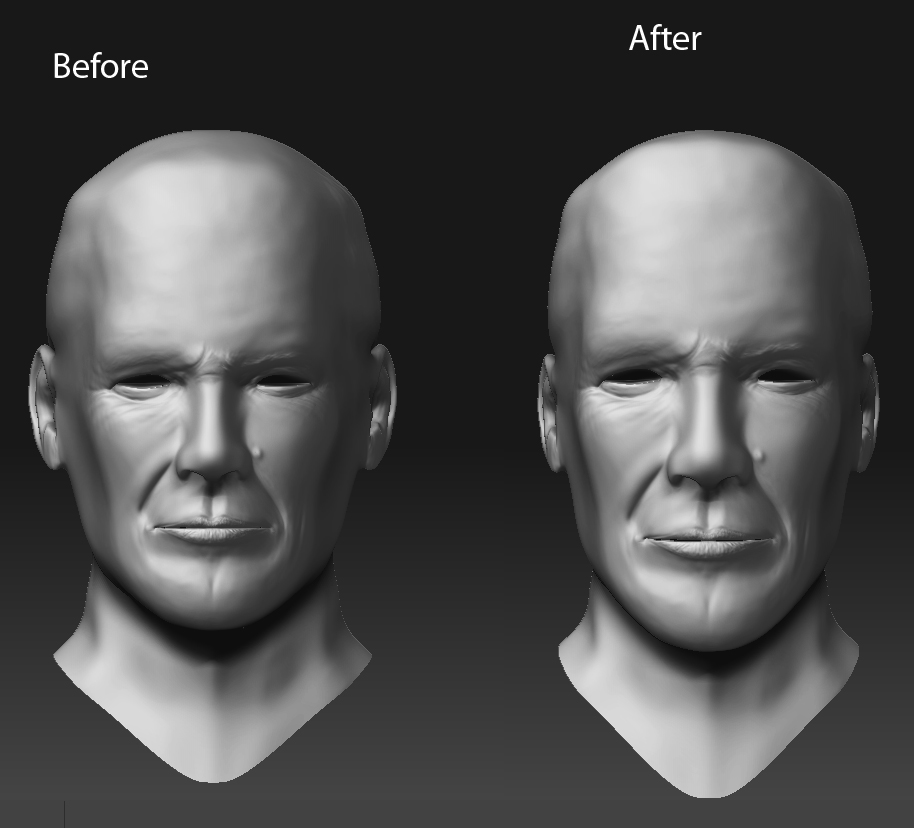

The model distortion looks like Perspective is turned on the Draw palette for one instance of the model, and not for the other. Simply toggle the Draw>Persp setting.
