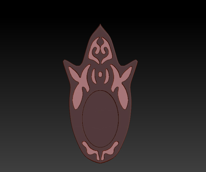

Hello, plz suggest any tool for cutting holes… I need make holes where unmasked area…

Extract tool made cavity inside model… this is also interesting… but I need simple holes…

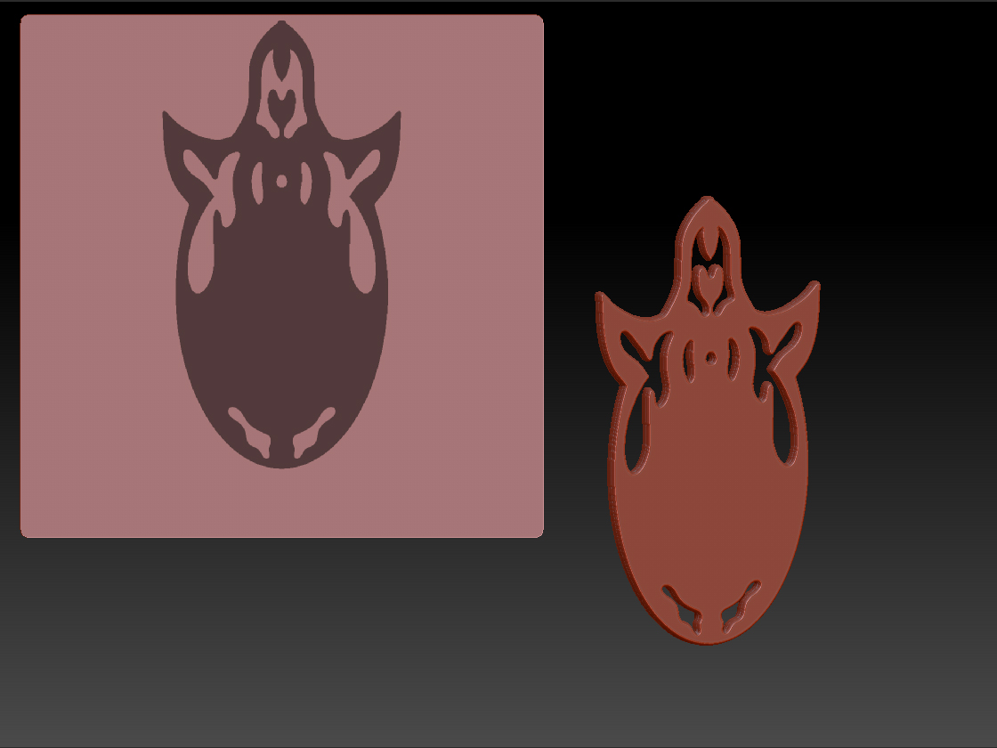

MrZmey: Sorry I was not very clear, you can create a polymesh plane subdivide it to around 1 million polys and draw a mask of the shape you want to keep then extract that. You will get something more like what you are looking for.
Here is an example image; I apologize for butchering your design:
