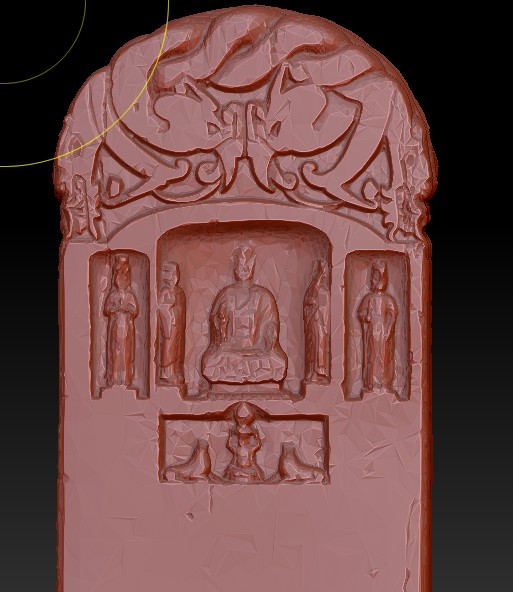

I’m a tester of 3D-scanning data.And Zbrush is a brilliant software that can display billions of polys.But I found a frustrating problem of normal baking ,here is the problem .
My plan is to creat Normal maps for this lowpoly model from the scan model .But Zbrush4 must bake the Normalmap from it’s own subdivision model .without a Highpoly model ,I even can’t use the spotlight to draw texture on models because of the low resolution .
I have tried the projectAll button and it cost me 4 hours to process, lossing some details by the way .I can bake normal maps by 3DMax or XNormal ,but these software can’t process our scan model .They have crashed when I imported the 400million polygon model .
I’ve searched internet for solutions and most of Zbrush users are sculpting details from a subdivided lowpoly model ,is there someone could help me out ?I don’t want to waste beautiful details of scan-model !
Thanks a lot .I will appreciate for your help !

Hi goast, thanks a lot for your reply .My english is not good enough to show my appreciation .
I’m a beginner of Zbrush ,and my Zbrush version is 4.0.I realized that you suggest me to "drop " my model to the canvas ,is that mean the project master ?I’ll learn that function immediately .
There is one more thing which confused me :The NormalRGBMat create a mat that is not a tangent normalmap, but I have tested yesterday .I want to put my lowpoly model in UDK ,or other VR platforms ,they can only display the right normal by tangent normalmap .How can I exchange the normalmap into tangent normal ?

Thanks for your advice .
I downloded xNormal yesterday ,the latest version is 1.37.1,I just have used it 1year earlier .I have to say :xNormal is awesome !This software figured all my problems .
Now I can use 2 different models to bake the Normalmap and by the way ,the 1.36version can export a polypaint obj format ,baking it to a base texture .
Now I have no problems of Normal baking from our scan data .Thank you very much !
Yeah ,I must apologize for my first post because I said the xNormal crashed .
This post may misguide the way of solution so I put my focus inside of Zbrush .At last I found that my xNormal crashed because I’m using a 0.8 version .But now ,everything is right when I updated to the 1.37.
Thank you again for your help ,I really appreciate that .:lol:
