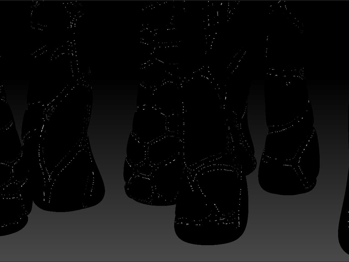

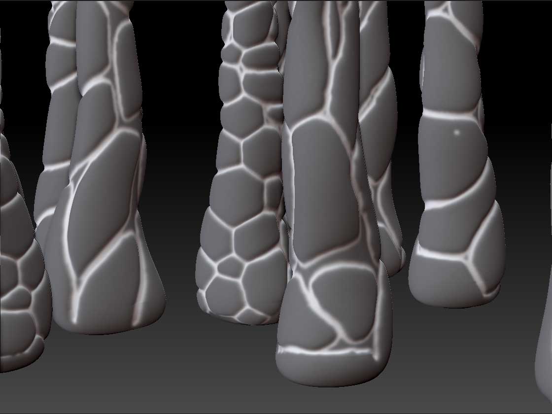

i am having this issue with ZB after i try to make a texture from polypaint see B4 and after pics…
whats going on ?

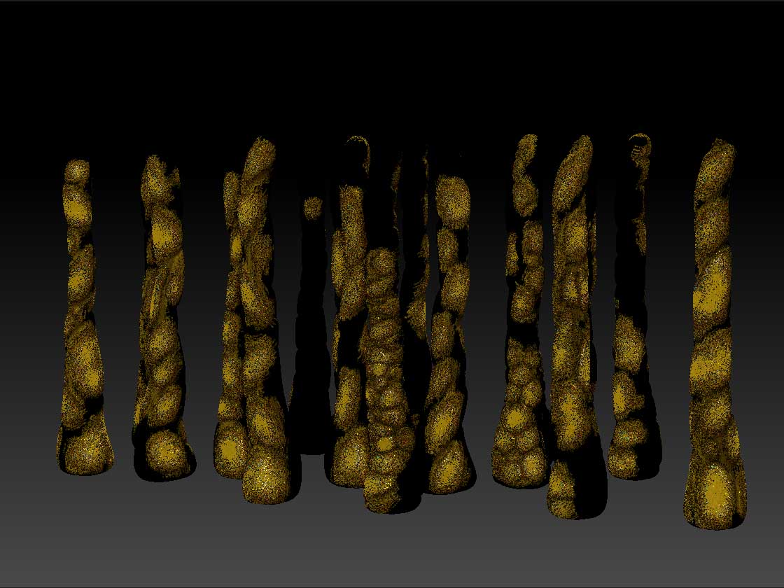

i am also have issues with “create texture from masking” below is whats happening B4 and rfter
whats going on ?
Just a guess… Maybe a problem with the texture resolution (as in it’s too low)?
You have to set your desired texture size in the Texture menu. Else I think you get something rather low (512?)

The second issue is easy. Any functions involving converting masking to alphas or textures in the new version dont appear to be functioning at present. A work around is to invert your mask, and use Color>Fill to fill your formerly masked shape with poly color, and create your texture from that.
Don’t know what you’ve got going on in the first pic
thanks guys… its not the rez of the texture , i always go with 2k…
I have come across the issue with the first pics , i think because i have the polypaint on a layer , which incidently if you leave on “1” and try to bake it down it crashes ZB, but if you lower setting to say 0.98 it doesnt. strange. i think there are some bugs in the texture/masking palettes and i just realised i cant put my ztools into ZB4 for some reason to get around these problems.
