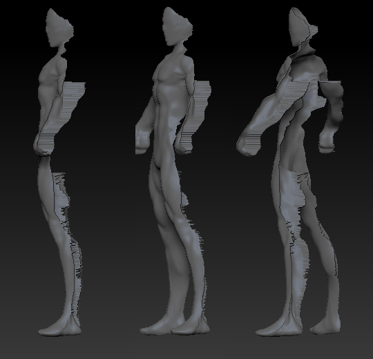

When I use the zproject brush to transfer detail from one sculpture to another it messes up the mesh. It almost looks like it eats half of the sculpture when I use the project brush, both sculptures are almost identical but one is more detailed. Does anyone have any advice on how to avoid having this happen ?
It almost looks like you are projecting with Zsub on instead of Zadd but it’s hard to tell. The Zproject brush will only project straight out into 3d space anyway and is kind of hard to control.

Thanks Mike, that totally worked. I seemed to have better success using the negative shell (outer) than positive with my head model.
