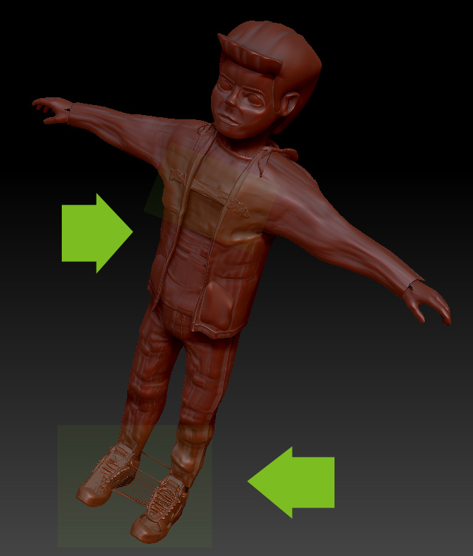

I did a pose with my character with transponse plugin, but when i tred to get back subtools, a weird problem appeared.
[transpose.jpg](javascript:zb_insimg(‘213221’,‘transpose.jpg’,1,0))
If i try to export the obj, it cames as one single mesh and if i try GoZ nothing appears (there isn’t any point).
So, is there a way to use this pose?
and mainly, what happened? how can i avoid this situation?
Thanks,
Carlos
i tried again, his time i only pressed Transpose button and then trans->subtool.
Just to check…and for my surpise the problem happened again without any change in the pose:
[transpose1.jpg](javascript:zb_insimg(‘213223’,‘transpose1.jpg’,1,0))
any ideias?

I think thats the point in using transpose plugin , it makes possible to merge temporalily everithing in one mesh, and then return to the subtools (at least the documentation says so…)

But about the mesh integrity…why does it happens the same mistake even when i just pressed Transpose button and then trans->subtool. (as at the second image)

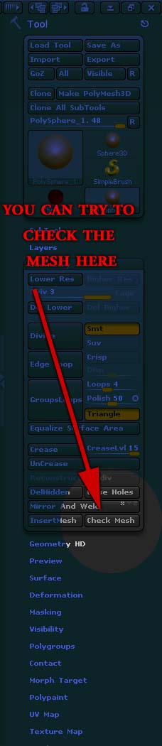

try to make a mesh check.
If it say is a bad mesh… the last hope is:
1-export your model in the lowest level of subdiv as an OBJ
2-export your model in the highest level of subdiv as an OBJ
3-reopen Zbrush
5- open your low obj file in zbrush
6- subdivide your low obj file to the level it was when you exported to the highest level
7- load your highest level to you newly subdivided low def obj.
hum…i think the mesh is ok, and the tests says only “Mesh integrity test completed successfully”
