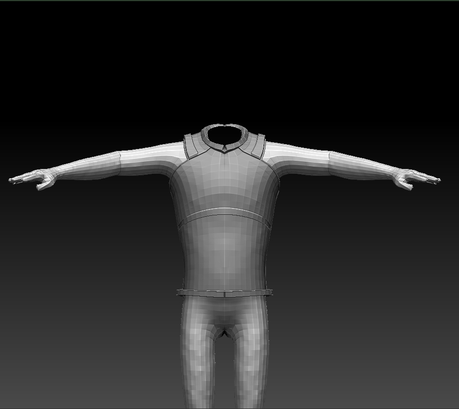

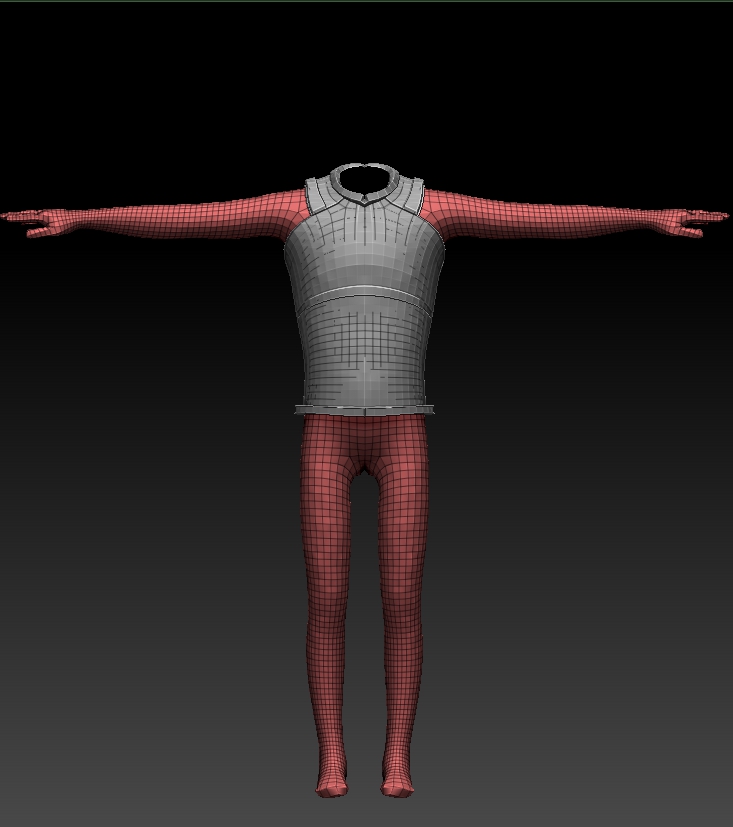

Hello Community, i am trying to transpose a model i am having via zsphere rig, and i am having this problem. The body of the model moves with a natural way but the different subtools i am using (Metal armor for example) are getting destroyed in the process. I dont to have any folds or presses when i am posing a warrior model and i am stuck in T pose permantly now.
Any advice would be helpfull.

If you are using the plugin then it would probably help to show some images of what’s happening.
test1.jpgtest2.jpg This is my model in T pose, and when i am trying to pose the arms using masks (via transpose master) i get those broken elbows. Same thing happens when i use zsphere method only this time it gets like jellybean arms and rest of subtools get “melted” away looking.
