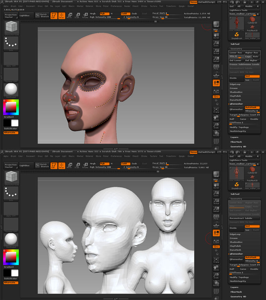

I´m in an intense battle against qremesher, as you can see in the picture below, it is giving me a lot of trouble when retopologyzing the edge loops in the eyes and SPECIALLY in the nose, I have tried several strokes with the Qremesher guides brush, but each times it gives something worst than the previous.
I have also tried toggling the Cstiffness to 100 and less strokes but the results are even worst.
I would appreciate a lot if someone could come up with a solution, suggestion etc.
thanks in advance
You should post a screenshot of the wireframe, but my best guess is because you put too much guides on the nose area. Don’t forget that QRemesher is an automatic retopology solution. More curves means in fact more constraints for the topology computing, which could result at the end in un expected results.
Perhaps in your scenario 15k may be not enough for the curve density you created on your model.
