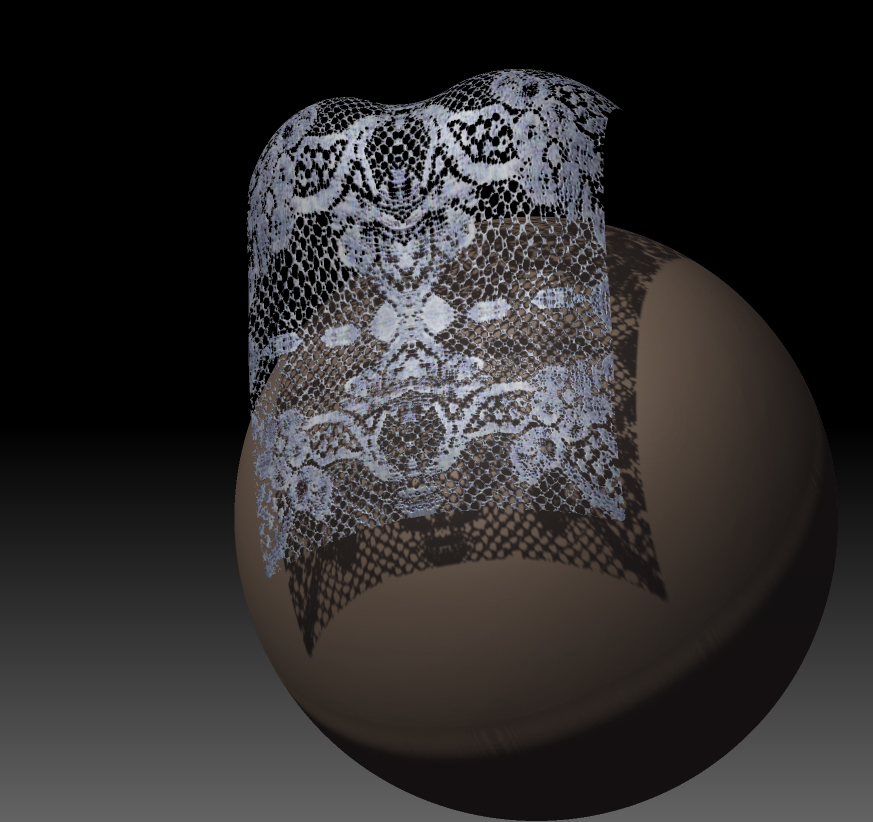

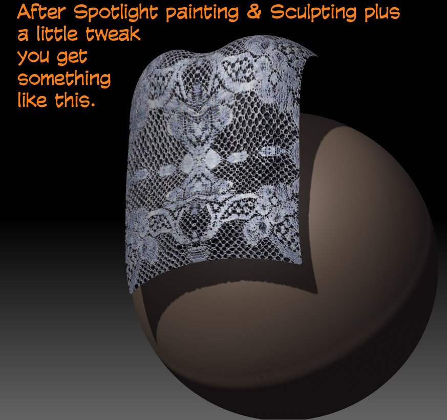

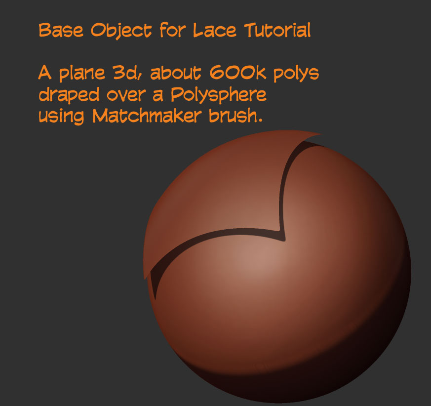

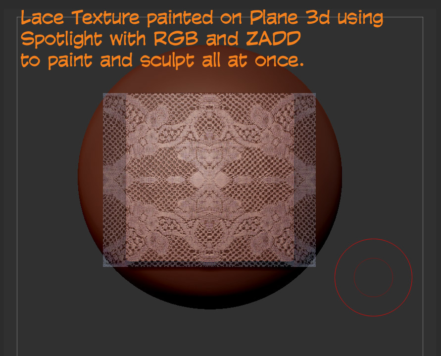

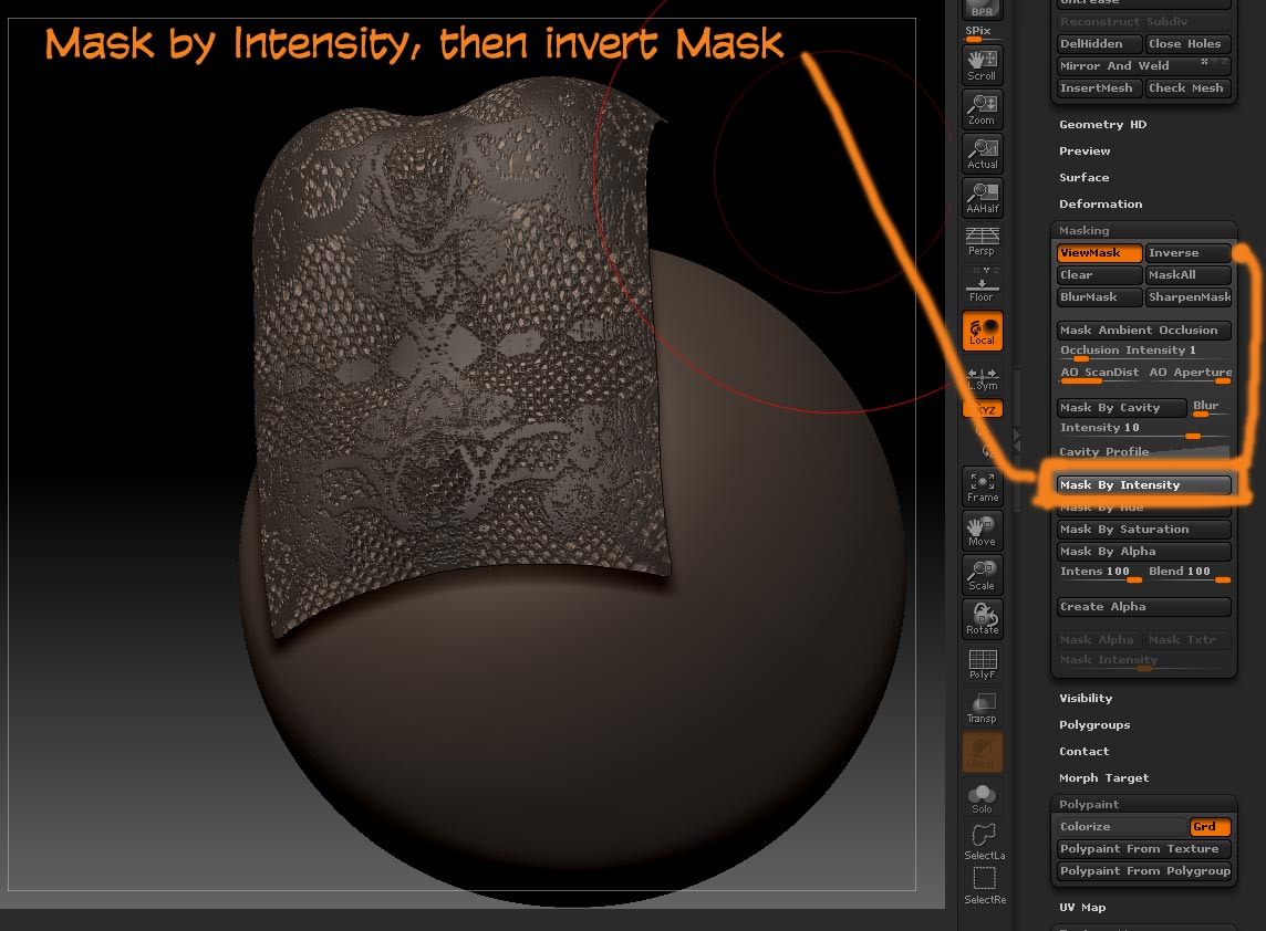

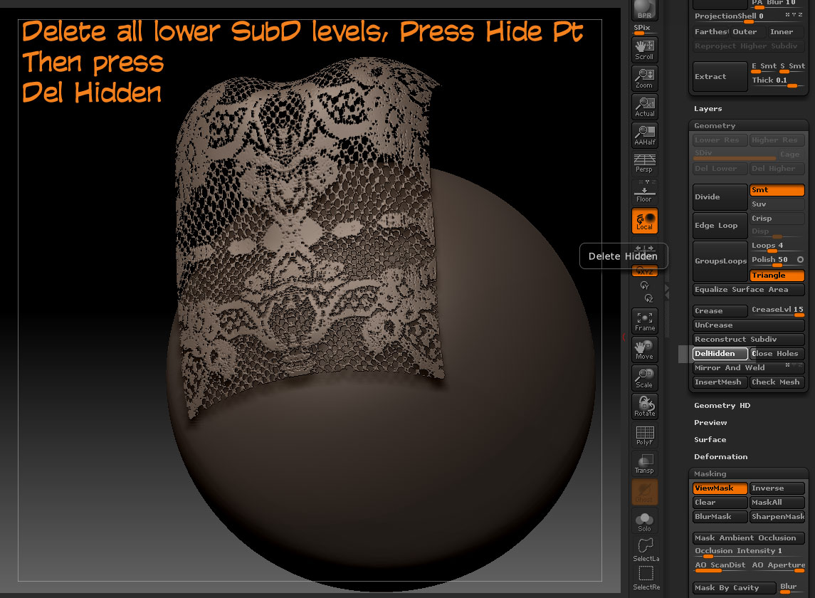

I had to make some lace yesterday actually, so I came up with this method. Pretty quick and effective. High poly lace though, you might have to adjust the method if you want low poly lace objects. This particular lace square was around 640k polys to capture the texture and sculpting detail in spotlight.
If you want lace that isn’t seen so close up, you can probably get away with much fewer polys and still give the impression of lace.
